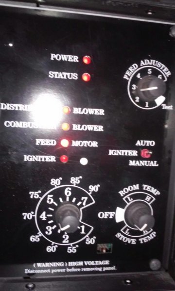

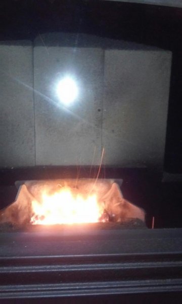

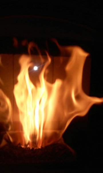

    My friend has a lazy flame now and here are the settings. It was cleaned inside and out just last week!
    Any comments?
    DexterDay likes this.
  20. don2222
    don2222
    Nov 10, 2013
    3,370
    4,702
    Salem NH
    We just changed the feed adjuster to the recommended 4 setting. What a difference!!!
    At 4 it must have increased the voltage to the combustion blower!
    Maybe that is the fix? Subsailor what are your settings?
