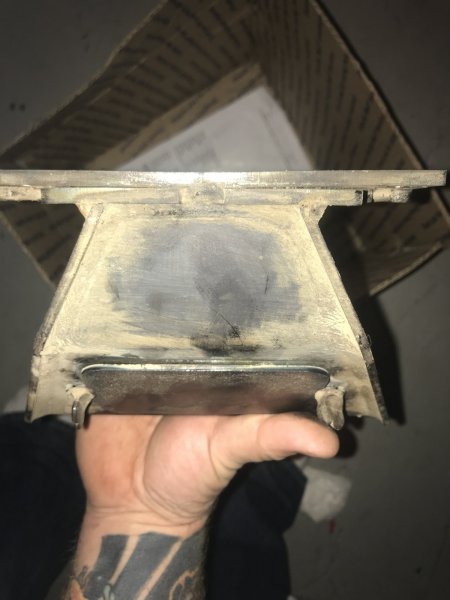

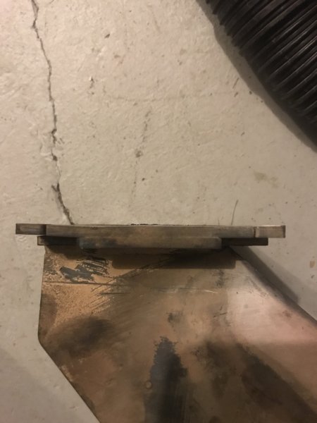

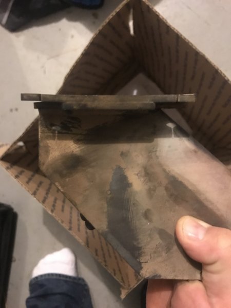

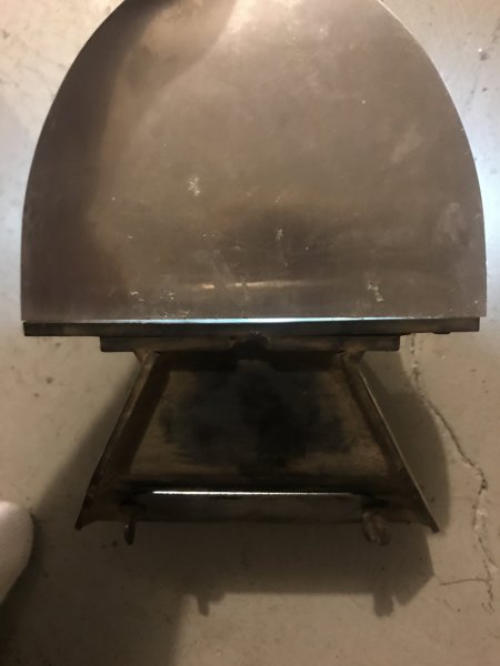

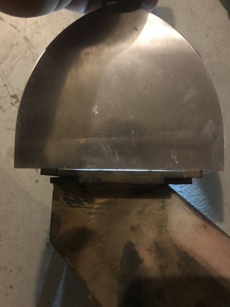

    She starts like a charm now. It’s at the stock +21 for the ignition cycle and it still seems like kinda a lot of pellets in the pot so I might adjust back to the -21 but she has a nice flame off the ignition and starts in about 7 min from the time from the auger starts till I have a flame. Not to shabby. Lw I think those 2 gaskets made a huge difference. The bottom left of my stock burn pot was definitely warped you can actually see it. I’ll take pics later and post them to show. The new one is a little warped too because of the welds but it’s the opposite way of the other one and the opposite way of the stove

    Glad to hear it’s all sorted out. Would love to see pictures of the warping you mentioned.

  16. D-Mac0211
    D-Mac0211
    Dec 7, 2014
    360
    854
    Upstate, ny
    As good as I could get for pictures.
