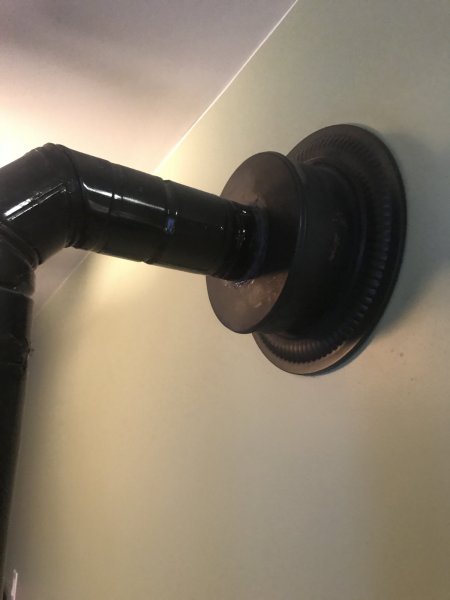

    X2 this is a concern. Without a tee there is nowhere for fly ash to collect. It just stays right there accumulating in the 90 elbow where air flow is critical. I suppose if it is cleaned out very diligently, it’s not a huge issue, but still not ideal.

    I tap the pipe and vacuum it out every time I clean it.

    This is the set up

    That’s red high temp silicone not rust or anything
    ivanhoe likes this.

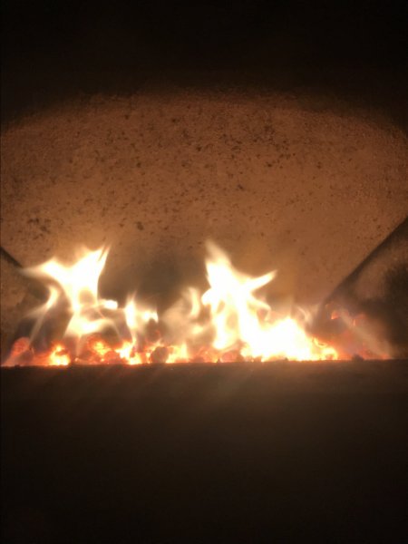

    The flame seems good it’s just starting it. It won’t start on its own right after I clean it and it won’t start on its own at all right now. I’m going to have my father in law put his draft meter on it this weekend.

    That’s my maintenance burn

    The ashes must be accumulating in the chimney part of the venting. Is there a cleanout door? If not, that could be the problem! After all those years it finally caught up to choke your stove.

    what the heck, D-Mac, why not put a tee where that elbow is? Some people do, some people don't.....but I can think of no good reason NOT to.
