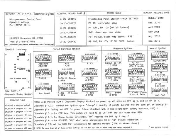

    I have this which says it’s +21 stock. Idk if this is right or not

    well, if youve got a p43, then on/off/off is correct for that unit, with a E revision board. As for the newer F revisions, you would need to check the appropriate settings for it.

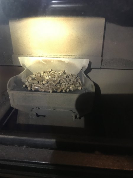

    Put it back to stock setting and this was after about 7 min. Not even a flicker or smoke signal. Opened the door and took pellets out and they were definitely hot but just not igniting

    I mean pellets are getting hot enough to where when I take them out they hurt my hand because they are hot

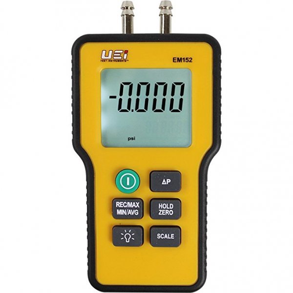

    Really sounds like a loss of vacuum somewhere.Draft reading would confirm.80 bucks at zon. Draft Meter.jpg
