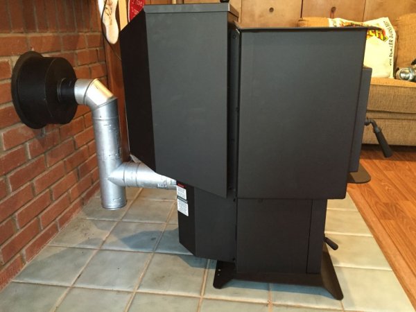

    Both methods work perfectly fine! In my particular situation, the P43 pellet vent terminates at the entrance to a 6" Class A wood stove flue. I was initially worried about doing this because I read and over analyze too much and people tend to express concerns this method can lead to improper draft and so forth. The stove shop told me don't worry so much. They were right. I don't have any issues, the stove runs like a top and produces fantastic heat!
    I will post some pics after, you are going to chuckle at the simplicity of this venting.

    Here is the P43 venting. It's 3" PVP into an 8" adapter. I've seen pictures of these adapters before, but this is the first time I've seen one in real life use. Behind the 8" adapter is a 6" supervent flue with an 8" outer ring that protrudes about an inch from the brick, so the 8" adapter fits perfectly snug over it, creating an air-tight seal. The 6" supervent flue goes 2' horizontal, and then up 20' to the top.

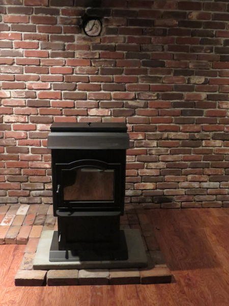

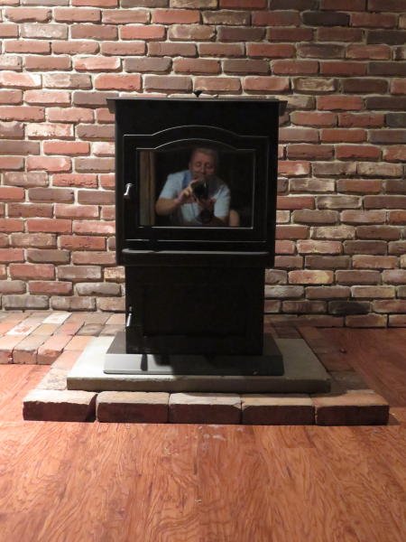

    Making progress on the install re did the hearth stove is in place ,now I need the pipe .
    Who's that man in the stove ??:bug:

    Eeek! There's a guy in your stove! A fugly one too!! I'm scared.
    O wait that was because I looked in the mirror!

    Looks great Willis!!

    Something is missing.

    Yep, great lookin stove Will, but Smoke's right....there's something missing from the pic. :whistle:

    I don't remember seeing any piping! ;)
