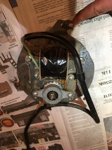

    Ivanhoe, Wildwest, ChandlerR, Nitro-Fish, thanks for your replies and your advice. My tools are still strewn about but so far I can say: Mission Accomplished!
    Full disclosure: in my 9 years of ownership I’d never pulled the stove out or removed the combustion blower. I’ve cleaned it on a weekly basis, done the leaf blower blowouts from the roof, and emptied the fines and vacuumed the access point to the combustion blades from the rear-since my double sided fireplace gives me that easy access. Having said all that, here’s what I learned:

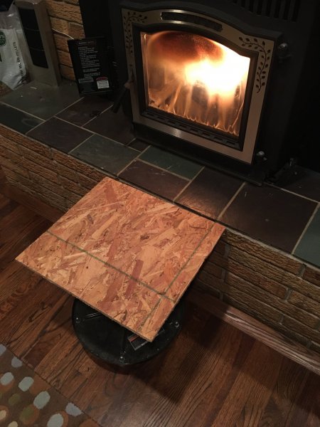

    I pulled the stove out and set the front of it on my adjustable height mechanics stool (Harbor Freight el cheapo worked great, needed 17” height)

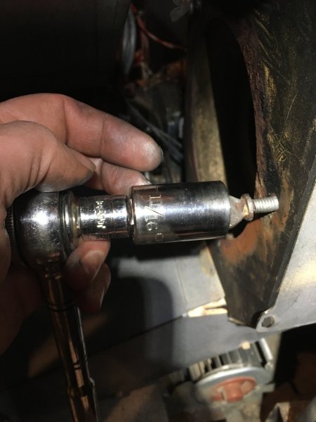

    The 3 thumbscrews holding the combustion blower in the exhaust housing were pretty much seized in there. Needle nose sorta worked but were clumsy so I did a quick measurement and found a 6 point 11/16” socket a great substitute for my weak fingers (this was prob my favorite ‘hack’ of this project).
    Having loosened the thumbscrews the plate was basically rusted to the exhaust housing so it took a little prying to loosen it from the face. Full disclosure we live in a valley with a creek and high humidity. Only recently did we install A/C.
    Once removed, I was finally able to loosen the set screw on the blade/impeller and remove it, but it was still pretty much seized the shaft. After a few impatient attempts and some PB Blaster I went full Sawzall on the shaft. At that point I had deformed the fan blades anyway so I just really needed the mounting plate to re-attach the new motor and new blade/impeller that I bought ‘just in case.’

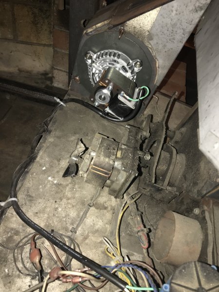

    Having disassembled it all I began reassembling. I took pics along the way and I knew the motor only re-installed one way, but following my own pics I mounted the motor incorrectly to the whatever plate that holds it in the housing. I had a 1 in 3 chance of getting it right I suppose. This is why I dont gamble.
    Having deduced that the motor was incorrectly mounted to the plate, I reexamined my pics and found proper orientation and installed correctly on the thumbscrews. I did employ some never seize on these screws plus the set screw on the blade/impeller.
    Having mechanically installed the replacement motor and blade/impeller unit, I set to reconnecting the wires from the motor. Only then did I realize the white to white, and red (stove) to black (motor) connections. Somethings you just take for granted-probably cause I disconnected the white to white connection first. Anywho...
    As my wife patiently observed my butt crack from the relative comfort of her down blanket, I reconnected the power, crossed fingers, and turned to Stove Mode.
    Immediately I noticed this new combustion blower was much quieter, maybe 25-30% quieter? Noticeably so. And, no crazy Harman Phil-Harmonic that drove me batty the last 24 hours.
    That’s my story and I’m sticking to it.

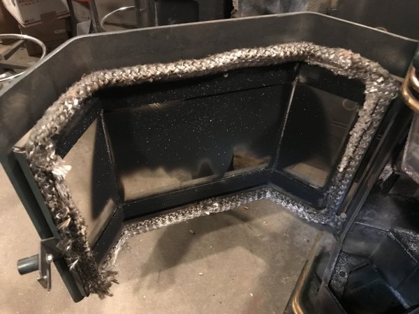

    Now my next problem is that I believe there is a big mistake somewhere and I if you can tell me what you saw on the Profile 30 it may help.
    The Door gasket that I see on some web sites for these 2 stoves is 1” diameter but I looks ridiculous because it flops around so much! The profile 20 takes a 3/4” door gasket and it is basically the same!
    Did you see a door gasket like this on that Profile 30?
