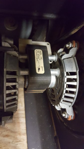

    I still have the original combustion blowers in both of the P61's, but I'm told I tend to overkill on the yearly cleaning, they have the double fan motors (Jakel). The new ones don't have the double fan motors, they say it isn't needed anymore, but heat is only good to warm people in the winter time, not our stove parts. I'm sure a bean counter decided it would save money to go without the dual fan model (after all, the stove manufacturers cant make money on parts if they never need replacing), and that is the reason for the change. I recently purchased a P68 that has the same combustion motor, but it's starting to make noise already (stove is only 10 years old); the owner had receipts for a new igniter (oem), a new auger motor & auger (aftermarket from pellethead), a new distribution blower (oem) and a new flame guide (oem) so its only safe to say, its next to go. This stove definitely didn't get the yearly attention that my 61's do, but I have it cleaned up and ready to go now, lubed the comb blower & quited it down after a thorough cleaning, but want to be prepared for the worst. I may be the guinea pig on this one if nobody else has tried the Fasco.

    Looks like your P61A is a 2009, both of my P61's are older than yours, the P68 I just purchased is a 2008, all of my Harman's have the double cooling fan set-up on the Jakel motors: Combustion blower P61 sm.jpg

    My P68 is a 2008 as well. The combustion fan motor has been replaced once. Neither the original nor the new were double fan models, I didn’t even know there was such a thing until seeing this thread. It’s a Gleason Avery motor on mine.

    My PB105 originally had a cooling fan on the ODE side of the motor just like that. I bought it in 2008. When I had to replace it, the Harman dealer said the new motors don't have it anymore.

    Yep, that's what I've been told, one fan only now; I believe the old style to be better around heat of any kind (even though there's not as much on the backside of the stove), extra cooling is certainly better for lifespan, the single is cheaper for the stove manufacturer, just my opinion.

    I had to do mine this morning as well. It started making noises a week ago and was screeching pretty good by this morning. I was also able to get the set screw out of the impeller with little trouble but the impeller wouldn't come off the shaft. Ended up cutting it. Mine is a Gleason Avery OEM as well. Mine actually does have 2 fans. There is a small fan that sits outside of the stove that I assume is a cooling fan for the motor. I don't know if that is what Nitro was talking about of not.
