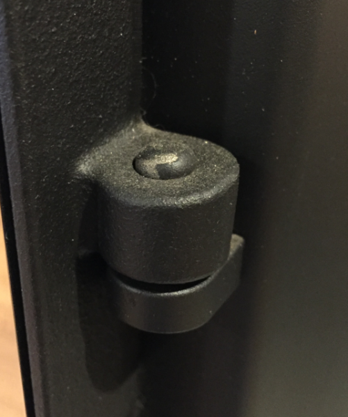

    It's cast. Here is a picture of the top hinge on my P43.

    Curious as to the year of your stoves as well as subsailor P61.
    Its sometimes a PITA to get the door aligned for the pins to drop in, especially if you are tired when doing it. This setup is definitely easier.

  6. ttdberg
    ttdberg Pellet Pig
    Apr 3, 2014
    3,596
    16,002
    CT
    The P68 is a 2008 and has the pins that used to pop up, but don't anymore. The P43 is a 2014 and has the new style door hinges.

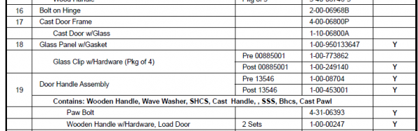

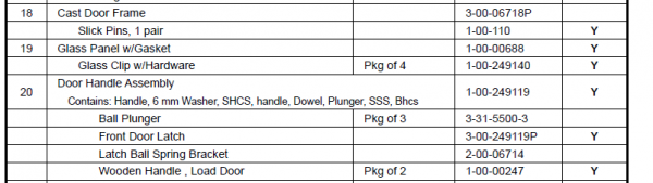

  16. bogieb
    12,552
    76,345
    By looking at the Parts lists, the doors are different and the P68 has slick pins while the P61 doesn't. While these pics are from a 2014 manual, I checked online and they 2017 manual says the same thing
    P61 P/L
    P68 P/L
    P68 door parts.PNG .
    ivanhoe, subsailor, gbreda and 2 others like this.
