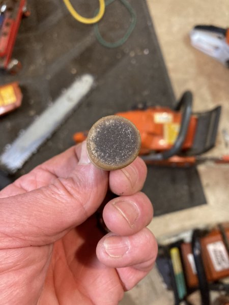

    My 5 pack of fuel filters showed up today so I replaced the plug and filter. I should have taken a pic of the plug before I dropped it in my full shop can. The post came off with cap and the plug looked like the saw has been running lean. Here’s the filter after I wiped it once with a towel.
    The good news is the saw fired after 5 pulls with new plug and filter. Thanks again for the troubleshooting help.
