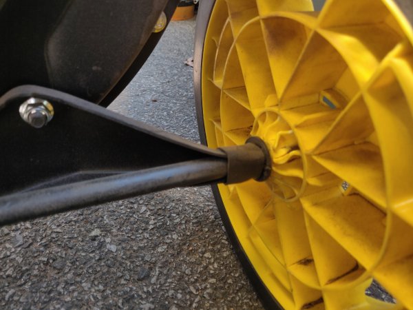

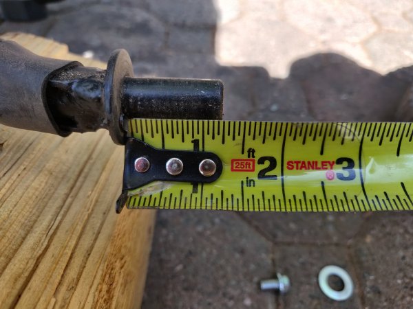

    Well here are the pics to show you it's not that easy. The axle is welded to the brackets so it's not a matter of just replacing the round stock. I'd have to fabricate a new bracket and axle.
    For now I will measure and find out if there is a replacement wheel I can slip on.

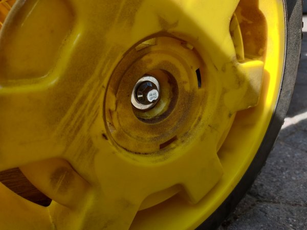

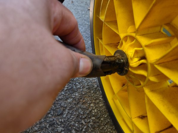

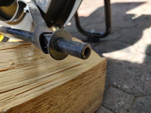

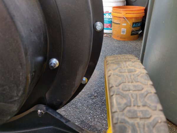

    The shaft only has 1.25" of room for a wheel. And the wheel is held on to the axe via a bolt that threads into the axle....leaving even less room to work with.
    I might have to find a piece of hollow steel stock that has an ID of 1/2" and an OD of 3/4".

    Sorry, but the last pic showing the tipped in wheels cracked me up. Gotta be a better wheel out there. Geez! Good luck.

    Can you possibly find a sleeve/bushing with same OD as the axle? If so you could use a longer bolt & wider wheel.

    That's what I meant to say instead of "hollow stock". However, I'd still only have 1.25" of support and I'd have to figure out how to secure it.

    I could get a longer M8 bolt, get or make a bushing (I have a drill press but I lost the damm chuck so I'd need to buy a chuck), and the just use a washer on the outside between the wheel and the bolt.

    And since everything is metric on this thing (and my splitter) I'm going to guess the axle is 13mm, not 1/2".

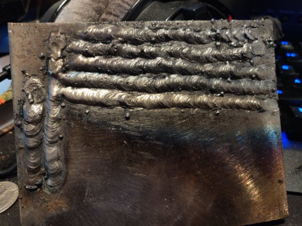

    I'm a noob. I have a HF 225 amp stick welding machine. I have 6013 and 7018 rods in a bunch of sizes. I've done some MINOR repair work to my Sienna fuel door and also recently welded two benches whose support rods (legs were all 1/2" round stock) were broken.
    I was practicing my beads a few weeks ago. Sadly I haven't practiced since then. But this is where I'm at. I guess I could cut out the stock rod, bend the sheet metal back a bit, and put a 5/8" round stock in there like you said.
    This was 3/32" 6013 I believe on a piece of scrap 1/4" plate.
    I have like 1.5 hours of welding total in my life so........just about zero. :D
