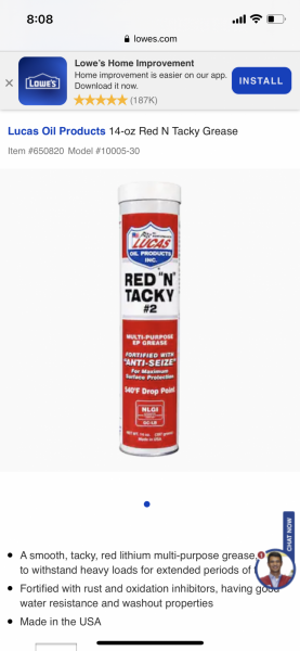

    Thanks
    Is this Red & Tacky high temperature, the best grease for these small wheel bearings?
    brenndatomu likes this.
  8. brenndatomu
    25,378
    165,415
    I'd run it...
    X3
