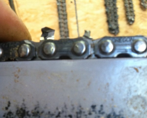

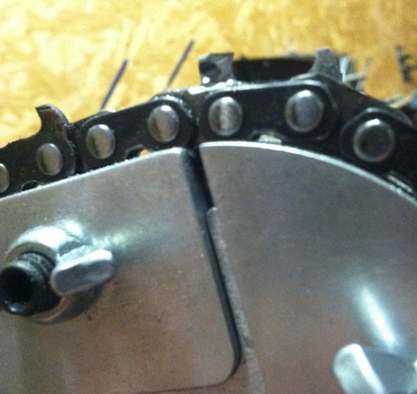

    I never did run a chisel chain where you needed a square file to sharpen... I believe from looking into it some years ago,, you actually file from the outside of the cutter in, just the opposite of what you normally would do on semi chisel chain, etc..
    MasterMech likes this.
  3. Hedgerow
    Hedgerow
    1,495
    4,849
    SW Missouri
    Yes.. From the point inward.
    Sorry for the blurry pics... Hard to focus that close with the phone..

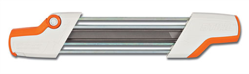

    *** Note *** This hand sharpening challenged person, ME, recently have become reasonable adapt at hand filing largely due to using a Pfred CS-X/Stihl 2in1 filing system. It setts the raker height at the same time it sharpens. You just have to round over the leading edge occasionally after sharpening has been completed. There are round files on both sides. Sharpen the cutters on one side then just flip the guide over to do the cutters on the other side.
    Pferd CS-X.jpg Handles are angled to be parallel to the bar. Simple to use. Stihl 2in1.jpg In the center: Round, Flat, Round files. The end snaps open to make changing the files easy. At $40 it is twice the price of some of the other filing systems, but since it does the rakers at the same time, it is worth it to me.
