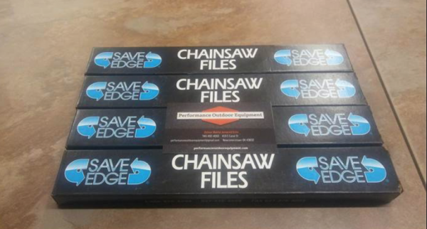

    I've been using these Save Edge files for years.
    Started when I was chainsaw carving bears and they were recommended on a carving website.
    you can get them on Amazon

    Have you noticed any difference in them over the years? I was reading a discussion on their double bevels and a guy chimed in saying he's been a farrier for a long time and the Save Edge files he uses for that job changed for the worse and he no longer uses them. I tried one of the double bevels and didn't like it. Never tried their round files.
  15. mikeward
    mikeward
    603
    4,042
    Long Island, New York
    I haven’t noticed anything different with the round files.
    I have a box of 7/32 and one of 5/32 and they’re both half full. If the change was really recent I wouldn’t have noticed till I reorder
