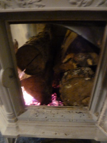

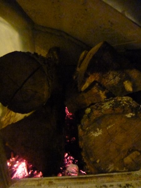

    I have to disagree about coal burndown being a problem in the PH without an ashpan. I have posted several pictures of my stove at the end of the coaling stage, immediately before relight. Here is a picture of tonight's box just before reload, and the new load ignited by the very small coal bed, without match or firestarte,r before I even have the door closed.
    I prefer the appearance of the stove without the ashpan.
    I believe the ashpan makes it very easy to keep from getting fly ash in the air when removing ash from the stove.
    I believe the ashpan prevents cat clogging, in the rare instance when one has an extremely tall chimney and extremely strong draft because of climate/site.
    I believe the ashpan is an excellent design and functions superbly.
    I do not have a problem shoveling out ash, and do not get an unreasonable amount of ash on the hearth. I get much more debris from my wood than I ever get ash out the door when cleaning, so it is not an issue. I sweep the debris, the ash is swept up with it. We may be talking a teaspoon of ash, which may come off the shovel when I place it back on the tool rack.
    For anyone with a normal draft and an average length chimney, I believe it is just fine to by guided by asthetics and get the stove without the ashpan if you prefer the appearance. Especially since, if you ever change your mind, it is very easy to add the ashpan.

    Here is the picture of the coal bed before reload
    concretegrazer likes this.

    I'll try again. Above were obviously the reload igniting.
    splitoak and Oldhippie like this.

    That's about as small a coal bed as one can have and have any coals. Had two separate piles of maybe two cups each, very small coals, and the fire lit off before the door was closed. There was almost no ash in that stove: none of significance. I certainly could have removed the ash in the back far corner had I felt it in any way of importance, but I would not have raked that down through a grate either. The ash was so low that the ridges in the bottom were clearly visible. And Woodstock actually recommends leaving a bit of ash or coals in the bottom of the stove, so I usually leave about 1/4 inch or so. Shoveled that load down to the grill to show you it is easy to do, and to clearly demonstrate how small the coal bed is. Another 20 minutes burning and there would have been no coal bed, only ash. On that tiny coal bed, upon reload the stove lit before the door was closed.
    I obviously agree that the ashpan is a functional stove enhancement. But, in my opinion, for over 90 % of potential owners, it's absence does not create a meaningful issue, and aesthetics can rule the day on the issue.
