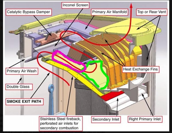

    I can get to the area that I circled with green with my vacuum, but not to the area circled with purple. It is just a moderate heavy dusty coating in the purple area; as noted above, it does accumulate down at the bottom of the green area to the tune of teaspoons/tablespoons (not ash-shovel loads).

    That area circled in purple is the open area that goes back to either side under the top, correct? I just use a china bristle round sash paint brush to brush the ash forward. I brush all the ash that is under the top to the depression either side of the bypass cover. Then I brush the ash onto a steel hamburger flipper that is about 1 1/2 to 2 inches wide and mounted at about a 45 degree handle to the shaft. Dump that into a tin can. Have been using the same can all season, and have about an inch of fine ash in the bottom of the can. I have no problem cleaning that area, assuming we are talking about the same area. The area that is a challenge to me is between the fins directly below the housing for the cat. For that, I have to fabricate a narrow tube extension for my vacuum cleaner. I'm honestly not sure if I get the area you have circled in green. I'm going to have to take a look next time I have the top up. I gather that is between the two areas I am describing.

    The side-view perspective is a bit deceiving, but I think we have the same problem area. What I circled in purple is not visible from any angle when the top is open (I think you would need to do some dis-assembly to view it in person. It is where the smoke travels when the bypass is closed, on its way to the cat. I can get my fingers in there a bit, but can't see in there.
    The area in green is what you see when you pull the cat and look down in past the cat's gasket. I have a short 90-degree tip for my vacuum that allows me to get that area nicely.
