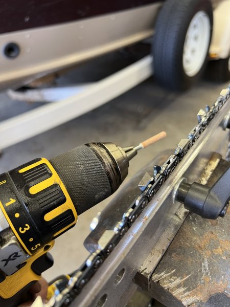

    Must be the grinding process, I found 4 work hardened teeth on a brand new chain I had to re sharpen on Sunday. I guess I need some of the circular grinding stones to fix them. I know it’s work hardened as I was able to file under one of the hard spots on 1 cutter.

    Purchased the cheap dremel 3 pack chain grinding stones in the 3 different diameters. Chucked up in my drill on high works like a charm, just hit it for a couple seconds and viola, the hard spot is gone… 6C9DBF78-2703-4C2B-9CA8-72B5516F1CA9.jpeg

    I have some grinding stones that ive used in my cordless drill. Have to remember to give that a shot. The diamond files did the trick though.
