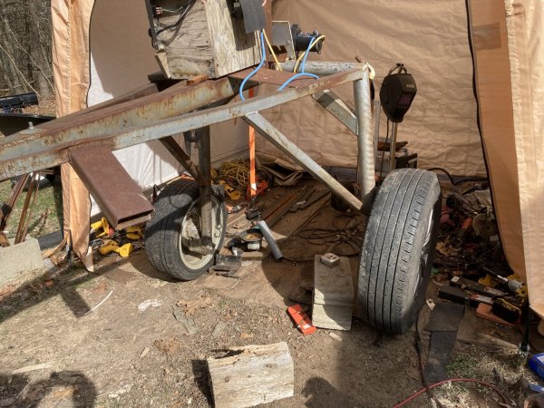

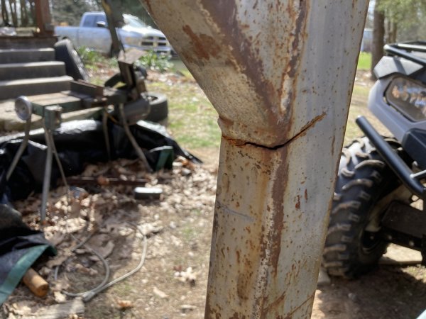

    I knew the log arch needed rebuilding. Was hoping to keep it as is until after the GTG. Well that wasn’t happening :) Found a crack in the tongue area. It’s made with very thin wall steel. Surprised it took the beatings it has.

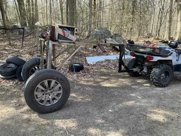

    The bigger tires were planned. Low profile tires suck in the woods. Too bumpy even deflated.
    I started with the tires. Cut 7” off the side arms to drop it 2” lower than how it came. High center of gravity isn’t good in the woods either. Could have dropped it even lower. I suck at math.
    Got the tires on today anyway. Next will be rebuilding that tongue area. It’s broke before and I keep patching it. Time to do better than patch.

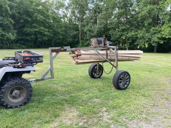

    Just on a quick trip around the yard I could tell it’s much less janky. I’m calling that a word :) Drop em down to 5-10lbs and they should ride even better, at least with a load on.

    I’ve had her up to 25 with a 2000lb stick on it. Gets exciting quick when the log starts swinging. I’ve found wrapping the chain around the log once stops a lot of that. Nonetheless an atv isn’t going to be too stable if something happens with all that weight in tow. I’m old enough to keep the speed down.

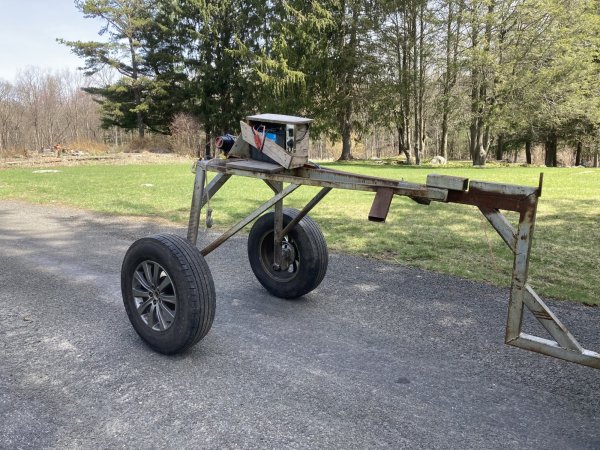

    Done for now. Eventually those struts need to be redone but they’ll hold for now. And a real battery box would be nice.
    Only pulled one log out of the woods but it’s much smoother.
