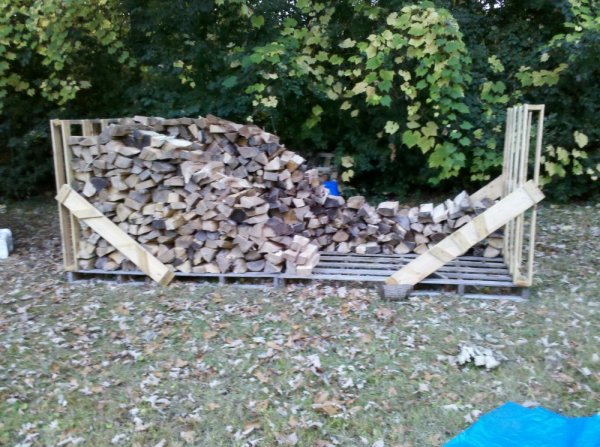

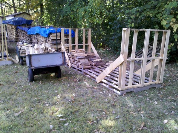

    If you want something free to stack on you can make some racks out of pallets, that's what I did Instead of buying more posts ,only cost is deck screws.
    You can even put tops on em and make little wood sheds

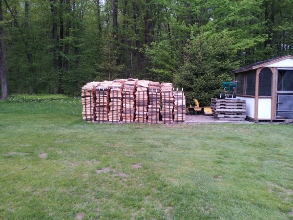

    Pretty much the same as a few others here. 6 1/2 footers driven in about a foot and a half with some fence wire run between them. Only down side is the expense of the posts. I've got about 50 of them now and I'm hoping they last a very long time. 20140520_190251.jpg

    Looks great Bret. They sure aren't cheap though are they. I was lucky that the previous owners of the house had left a bundle of them for us when they moved - I wanted a couple more so I bought a five pack at lowes without looking at the price. My jaw almost dropped at the checkout.
