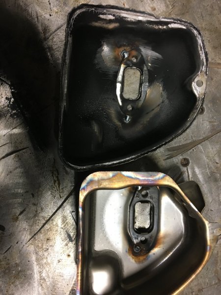

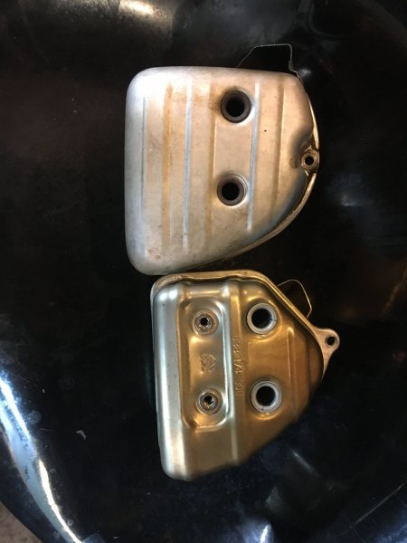

    Barcroftb showed ya the 7910 muffler. So maybe this will help the 6421 guys.
    M2theB, DexterDay, mdavlee and 2 others like this.
  8. clemsonfor
    clemsonfor
    15,996
    37,478
    Greenwood county SC
    Picture is verticle? Which one is the one on left and right:hair:, not sure how you had it orientated when you took the pic?

  9. Barcroftb
    Barcroftb
    Sep 30, 2015
    3,162
    18,652
    The Mitten
    That would be the 7900 on top and the 6421 on the bottom.

    I just remembered you said one was stainless, I guess I could of gone back through the posts and figured out which one was stainless and then would know as wee. But thanks for the clarification :D:handshake:

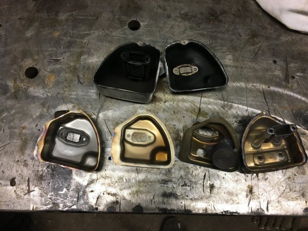

  11. millermodsaws
    millermodsaws
    Jan 15, 2015
    657
    2,010
    64479

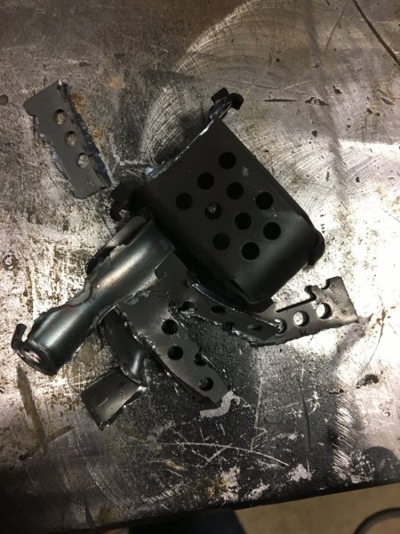

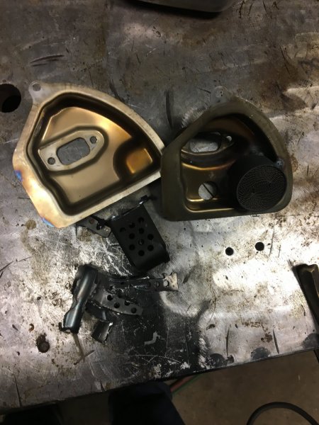

  13. millermodsaws
    millermodsaws
    Jan 15, 2015
    657
    2,010
    64479

  14. millermodsaws
    millermodsaws
    Jan 15, 2015
    657
    2,010
    64479
    However. These don't need to come out. I just do it for weight reduction. IMG_1189.JPG

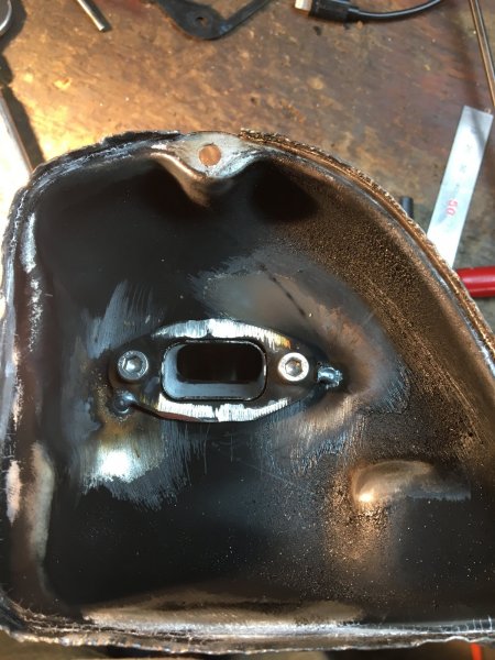

  16. millermodsaws
    millermodsaws
    Jan 15, 2015
    657
    2,010
    64479
    As you can see I already did some grinding on the cylinder. But her she is bolted back up. IMG_1190.JPG

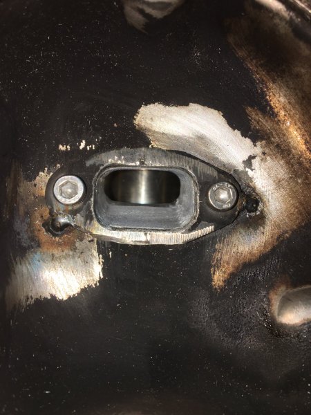

  17. millermodsaws
    millermodsaws
    Jan 15, 2015
    657
    2,010
    64479

  18. Horkn
    29,224
    166,820
    It looks like the 7910 muffler is physically a bit bigger than the 6421 muffler.
    M2theB likes this.
  19. millermodsaws
    millermodsaws
    Jan 15, 2015
    657
    2,010
    64479
    It's different shaped. Lol. But it maybe with that corner squared off.
    M2theB, Horkn and Barcroftb like this.

    Or just look at the way the mufflers would be upright. Deflectors on the top. So that would give you a good orientation...
