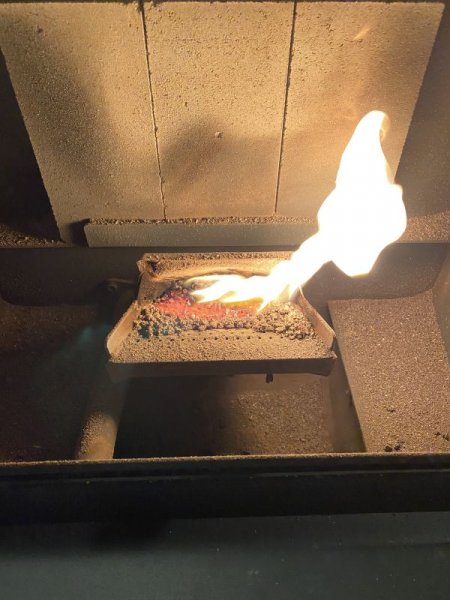

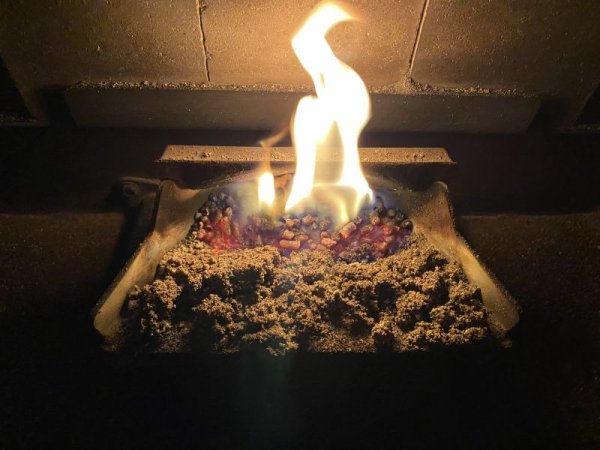

  15. ttdberg
    ttdberg Pellet Pig
    Apr 3, 2014
    3,575
    15,895
    CT
    Picked up a batch of the Virginia Goldens at the beginning of the season. Think I mentioned before, it's one of the best batches of EZB I've burned. Fast forward to a couple weeks ago. TSC gets in another load of them, so I went down and grabbed some, and like unbidden mentioned, these are night and day different than the first batch. The mineral content in these must be through the roof. I've seen Luneyburg post a few times now about the batch of EZB he has producing clinkers. I never would have believed it (or the extent of it) unless I had seen it with my own eyes. Except for one other time with a super-bad batch of FSU, I can't recall ever seeing ash that forms like this. I guess you really would call it a clinker (or a clunker in this case, lol). It's one big solid mass that forms pretty rapidly (that picture was taken 8 hours after a clean startup). You can slide the Harman tool under it and lift it up as one big piece and the underside is like red hot coals. It makes the flame start to shoot forward into the glass. When you shut the stove down and the mass cools off, it becomes more brittle and starts to break apart like you see in the picture with the quarter. For reference, I also included a picture taken with the original good batch of VGs from the beginning of the season, that one is 12 hours in from a clean startup. Talk about a lesson in pellet inconsistency!
