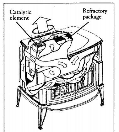

    A downdrafter is any stove where the flue gasses are forced to travel downward at some point in their path from the firebox to the chimney. Almost universally you find downdraft setups in top loading stoves, its used so that the secondary combustion system can be placed in the rear of the stove and leave the top clear for the loading door. In placing the secondary in the back, you need to force the smoke to travel through it - so it must be in a separate chamber with a bypass to engage or disengage it (both cat and non-cat) and that bypass is usually a damper at the top of the stoves inner rear panel that opens and closes a straight shot into the flue exit (fireback).
    When the bypass is closed smoke will take an alternate path to enter the rear combustion chamber. It either will be a second opening right below the main bypass, and being up high the smoke will then have to travel down through the rear chamber and then though a side passage back up to the flue exit; OR there will be an entrance to the secondary chamber at the bottom which makes the smoke have to travel down inside the main firebox to enter... like the old 1970s Vermont Castings 'horizontal burn' in the early Defiants, Vigilants and Resolutes.
    In practice today there are two main categories of downdraft stoves:
    Downdraft Catalytic
    - VC Defiant, Encore, Intrepid, and catalytic inserts. Also the out of production Jotul F12
    - With the bypass closed the smoke goes into a ceramic chamber in the back and travels down through the catalyst
    Downdraft non-Catalytic
    VC Defiant NC, Encore NC, Resolute Acclaim "Everburn" & Harman "Fire Dome" stoves
    - With bypass closed the smoke goes into a heavily insulated rear burn chamber and mixes with superheated secondary air
    The trouble with downdraft stoves in general is that because the smoke has to change direction multiple times there is a lot more restriction and they need a stronger than average chimney draft to keep things moving and work well. In a VC catalytic stove for example the primary air enters in the lower back, travels around the ash pan, up the side walls, forward to the airwash, down the front glass, throught the primary fire, into the catalyst intake hood, down through the cat, sideways out of the refractory exit, up through the back casting and then horizontally out of the rear exit! I count over 10 90degree turns in the path before it gets to the chimney liner.

    That picture of the convoluted air, smoke and exhaust paths is really neat, Jeremy. It looks kinda like a diagram of the on/off ramps where several freeways converge. I've never seen a schematic of the Encore and Defiant cat stoves - where did you find it? Good description of a downdraft unit too, thanks.

    Jhark, great post, thanks! Scary diagram and description!

    I found it in the manual for the 2140. The old manuals had a lot more useful information in them then the new 2550 manual. I did a lot of research during my rebuild.
