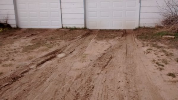

    And this was today with no snow!

    Seeing as how that garage is right at grade level, you really could use a small apron at the entrance of it.

    Apron? Like this?
    How far out from garage and what material? Benenfit is mud control?
    Also I am not sure it was always at ground level, this house was vacant for many years, and the snow drifts leave behind a lot of dirt when they melt off... I have a new hump in the back yard from the dirt left behind from the blob snowdrift.

    That apron would work great, either asphalt or concrete with a good base!!

    Hi guys and Stinny I hopefully have a truck coming out next week if the late snows finally let up, only 3-4 yards of concrecrete, I know that truck can hold more. What is the least I can can get by with on an apron for the garage door? Like 2.5' or more like 10' ?

    From the looks of the ground there (maybe can't really tell with the pic) it almost looks like you'll have to have some of it removed where the drive is and then stone/gravel could then be used. It looks as though that's the only way you're going to be able to have the finish drive grade end up lower than the garage floor. A 6' out apron ought to be fine as long as you have a little pitch away from the garage.

    Can a bobcat do what needs to be done removing the dirt?

    If the ground is pretty soft, it ought to work perfectly... fun too, if WWW was drivin... ;) Is there a slight grade down to the road from your garage or is it flat?

    I think there is still a very slight grade to the road, so much dirt and sand blown in by winds and trapped on snow drifts over the years the ground level is higher than when the house was built. If the weather is right I will be driving the bobcat too:) Move a bunch of dirt around and get this place more functional, dirt has built up along the west fence atleast a foot over the years :eek: We will move that too depending on the length of the bobcat rental.
