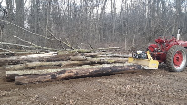

    Here's the winch mounted to the back blade on the M
    Here's the beginnings of a log deck in a hayfield last spring. We pulled about 5 cord worth out of a swamp, skidded them up the road & decked them here in about 4 hours. 1/4 mile pull. 20190316_153636.jpg

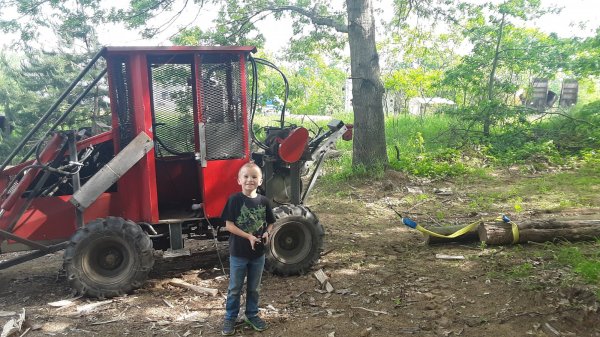

    Here's the mini skid with some Pine logs being operated by my grand son.
    The big winch I just pull the logs tight to the back blade, lift & go.

    Yes & no, I paid $ 3k for that winch. It's a mile marker 12k with a Honda engine. Electric winches overheat too fast. This thing just pulls & doesn't care.

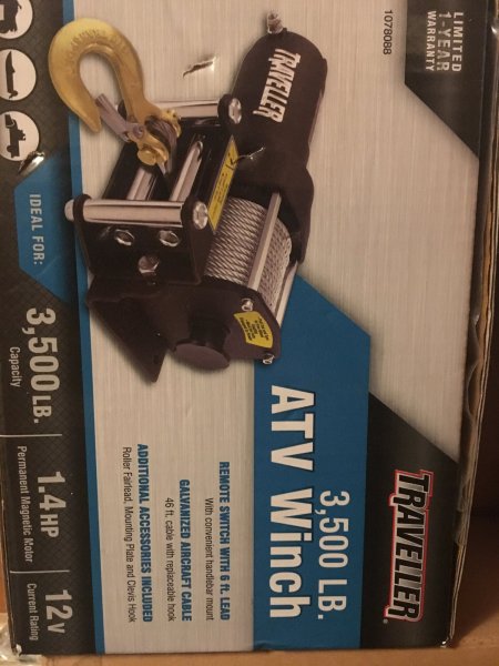

    I had a little ATV 1.4 HP winch on the tractor and it would oevrheat and stop. It didn't cost much, but now that I've bought a bigger saw for some bigger wood a gas powered winch is next if I'm gonna get serious about getting maple out of the maple swamp in the Winter. Right now the bigger saw is for some huge oaks and they're not in the swamp.

    1.4 Hp?? Could you elaborate on that? Was it DC or gas?
  13. billb3
    10,513
    54,567
    12 vdc
    From the little I used it I decided it was too small for what I was doing. Even though I wasn't trying to move logs more than about 800 pounds. 14 inches x about 15 feet, maple.
