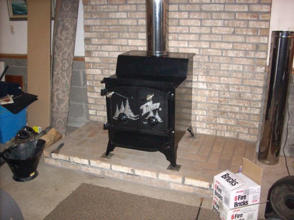

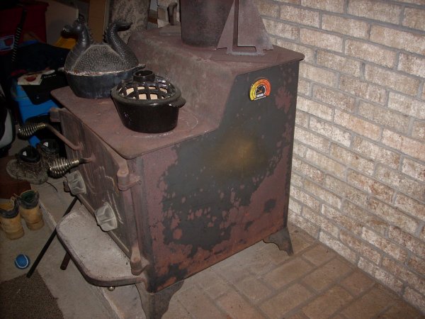

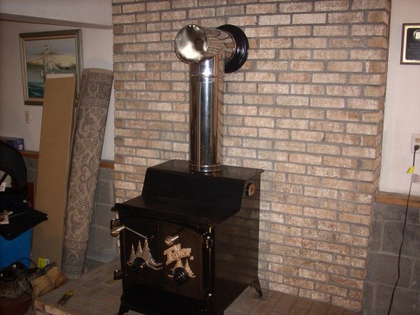

    Here's a side by side before and after... Wow! o_O
  4. Well Seasoned
    83,790
    Wow, what a difference!o_O it's like night and day man!

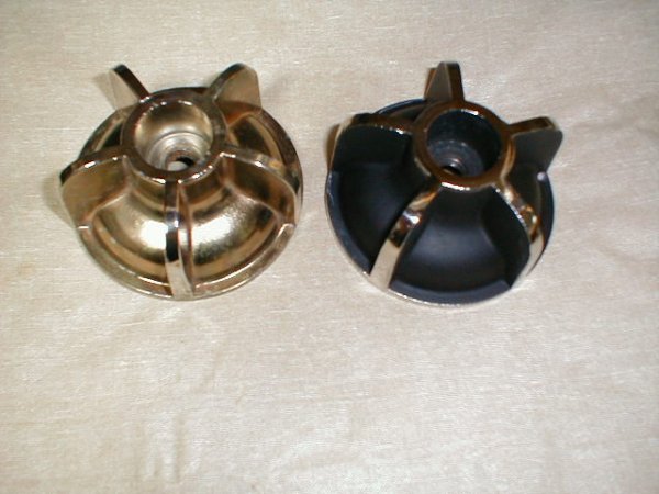

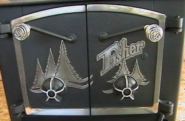

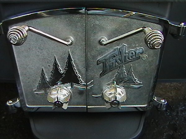

    You aren't done yet Dave. After you see these, you'll want the dampers to match what was used on plated doors;
    You can make your old black painted knobs match the dampers on Nickel Plated Doors by wiping paint off fin edges with Mineral Spirits before final heat cure. If already cured, Lacquer Thinner. There were two dampers. One with polished edges and one brushed edges. If yours are polished, use ONLY metal polish. If edges are rough, Scotch Bright ACROSS fins, NOT lengthwise the easy way.
    Here are the two caps for plated (or high lighted - non original) doors. Huge difference and doesn't take much for the original look;
    Aluminum Dampers; New Old Stock; Brushed left, Polished right. Original look for Nickel Doors.
    Even black doors look 100% better with this treatment.
    Here is a new original one with Fireplace Legs like yours. Notice high lighting around door edge if you want to match plated doors;
    Grandma Baro 2 9-2011.jpg Only the front has paint removed from Nickel. The door side edges were rough and painted black. These are the brushed caps.
    Brass plate doors use SOLID BRASS dampers you finish the same way;
    Solid Brass before and after.JPG New unused old stock on left; Finished with Satin Black paint, Mineral Spirit wipe the polished edges right. That is the original look for Brass Doors.
    If you have doors, handles, caps, bolts and rivets plated they will look like this before paint inside and out;
    Insert Nickel  2.jpg Paint and again wipe raised areas with Mineral Spirits.
    Notice original above is not as highly polished as replated doors.

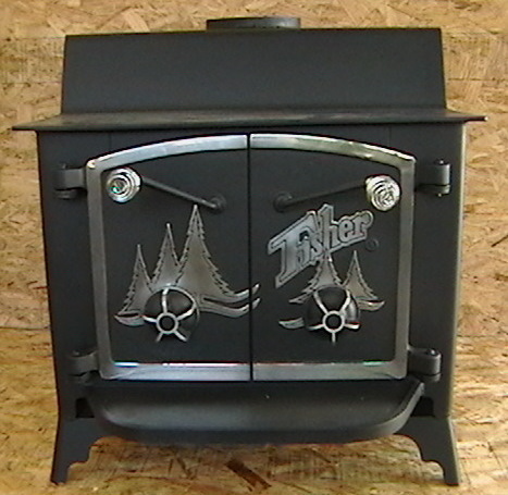

    That is beautiful Coaly. I'm going to put the effort into the XL when it's time for that. Grandma happened to fall into a $$$ situation so I wanted to do what I could with what I had. I would love to do all that, but I got to get her ready for the up and coming winter, and she is now in "much" better shape that she was and doesn't look half bad either! :).
    Well Seasoned and HDRock like this.
  13. WeldrDave
    10,205
    56,291
    You gotta admit, Those Fishers "are" very pretty all dressed :p up and there is no stove as pretty as the XL in my opinion! :cool::) With maybe the Ideal steel hybrid stoves as the exception! :whistle:

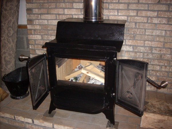

    Grandma got her first light off today. The weather stayed a nice 65* and light breeze so I opened all the windows and got every fan I owned out and lit her off! As expected the new paint smoked a bit and I ran her most of the day around 400* and hit about 525* once. The paint is set now:) and everything performed as expected, I believe she is ready for the for the winter. :cool: The draft with the new pipe and the chimney clean as a whistle, I didn't get ounce of smoke or back draft, It sucked like a Hoover :p.
