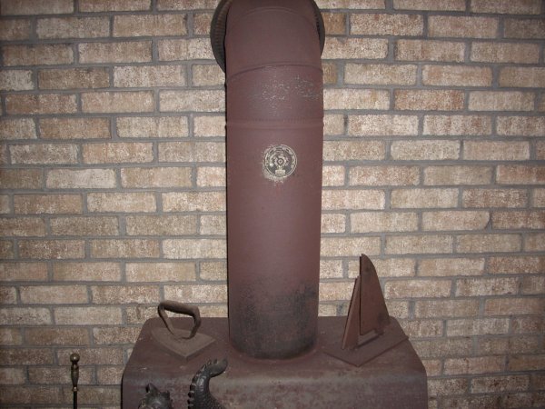

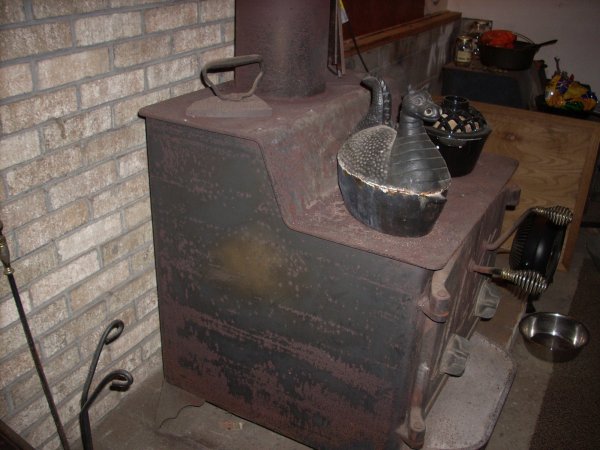

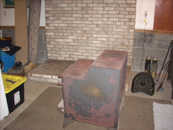

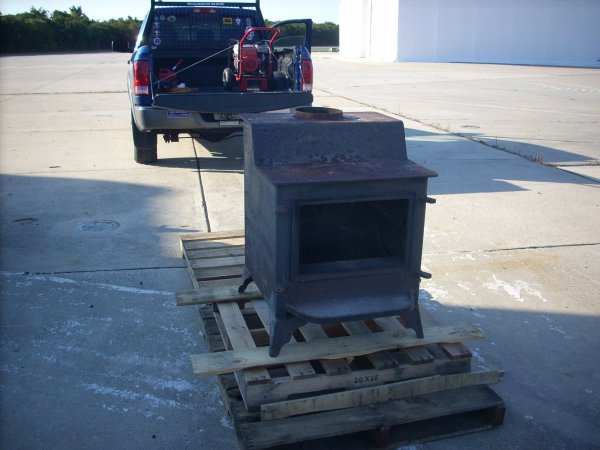

    Hello all,
    Well most of you know Grandma has been here for about 35 years and has been as faithful as you can get! :tears:

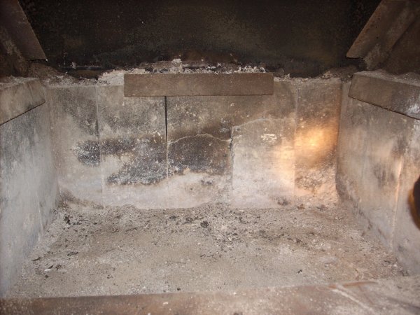

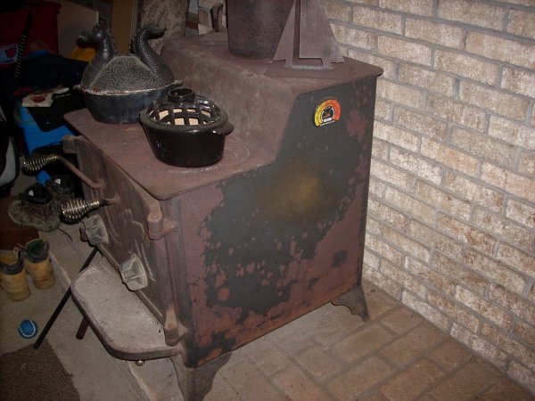

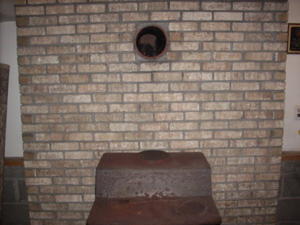

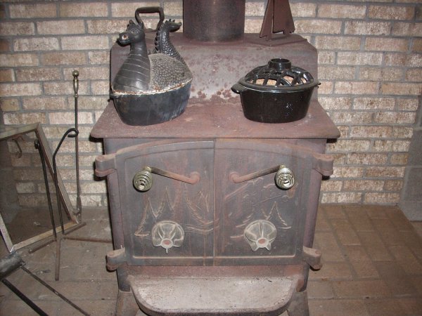

    Well it's time to give her a full facelift,:cool: new dress and some shinny stuff! :banana: If all goes well I'm looking to get her doors nickel plated, I just ordered new spring handles from woodman's for her and the XL this afternoon and I'm going to bring here down to "parade rest" this weekend weather permitting. I got some studly men from the work place are going to help me get her out, It only requires :pete::cheers::drunk:… I will keep this post running, I just ordered 25 fire bricks from my friend so she will be relined and Here is the first set of pics before we remove her this weekend, I'll do the progress pics as we go.:binoculars::cool:

  2. papadave
    82,448
    Yep, looks like she use a little TLC there, Dave.
    Nickel plated doors, eh? Fancy.
    :popcorn:

  5. My IS heats my home
    My IS heats my home
    Dec 1, 2013
    7,394
    17,637
    Albany, NH
    You can tell she has put her work in over the years. Aside from the rust and a few wear spots I think it'll clean up nicely.
    Firebrick replacement is a no-brainer, always a good idea after so many years. How are the interior parts hanging in there?

  8. WeldrDave
    9,283
    48,440
    Inside is in good shape, "dirty" but in good shape. I'll know more though once I drag out the fire brick. :whistle:

    Fire Brick is actually easy! :) First thing you always do before removal is make a drawing or snap a picture of the location/s of the bricks and install them in the reverse way you take them out. Fishers are relatively straight forward, you take out the sides, then the back and bottom last. You may need a concrete/masonary blade for cutting, I have one for my 4-1/2" angle grinder, Any good hardware has them.

  15. WeldrDave
    9,283
    48,440

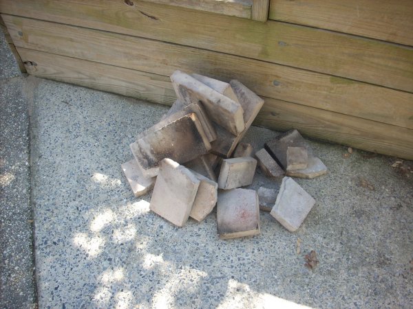

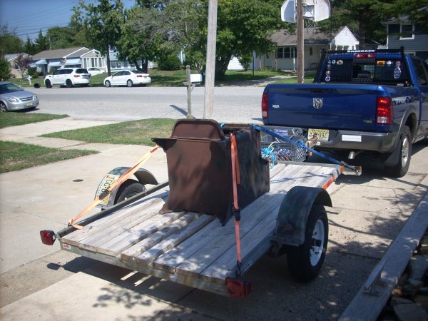

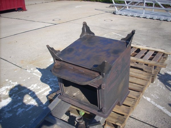

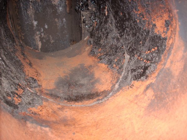

    Today A great friend and I started to remove Grandma! She had a lot of crap up the chimney but I didn't clean it like I normally do come spring.:eek: So, after some B!TC#!NG:headbang: and complaining:picard: along with getting dirty, it's out the door and on her way to the refinishing area. :whistle: The fire brick for the most part was in "ok" shape, had 5 cracked and broke but she's getting all new.
    More to come! :popcorn::cool: Beer to commence! :drunk:

  17. WeldrDave
    9,283
    48,440
    Grandma on her way to the Hair, makeup and dress makers!:D:tears: DSCN2138.JPG
