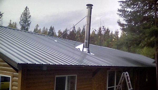

    I added 3 feet more to the chimney today, we'll see what difference it will make over time. I'll probably light a fire tonight, it is just not quite cold enough yet. I also got the snow divider installed, which I really have been wanting to do before it snows.
    When I pulled the cap off, I peered down into the chimney to see if I should clean it. There was nothing but a little ash, not worth bothering with. I have only put about 1/8 or a cord through it so far, so I wouldn't expect much, but it was good to see all the same.

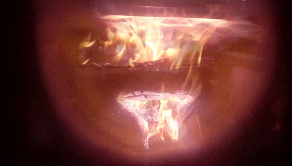

    OK, just lit a small fire, just 14" splits. It is 47 degrees outside, so not real cold, but the stove is drafting pretty well, and no spillage when I open the door.
    Photo below, not even quite 200 STT yet, but burning real good. (Sorry for the dirty glass.) Good blowtorch effect in front of the doghouse, despite that the fire is sitting back a way from it.
    I think it made it quite gooder, time will tell.

    I think keep doing what your doing. Could you switch from a 90 to 2 - 45s if there is still an issue? Roof pic looks great btw!
