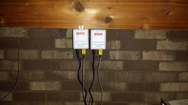

    17,268
    60,522
    They are slow , the other day firing up the stove cold , I noticed , pipe magnetic thermo was 150 my digital was at 600 , that's inside the pipe though

  9. HDRock
    17,268
    60,522
    Yep :D I got the digital thermometers with the over fire alarms, but the magnet mounts are still there and working fine.
