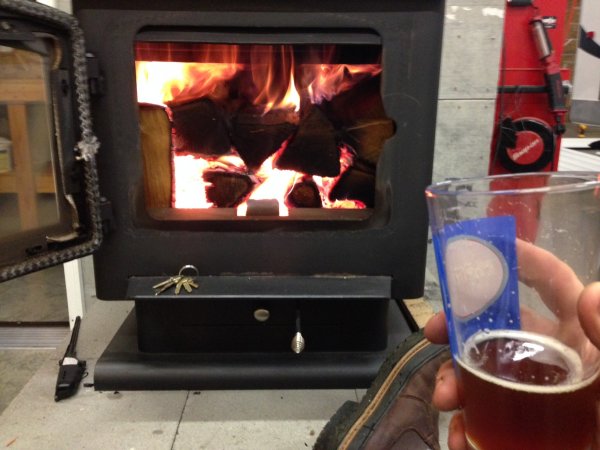

    Load her to the top, pack it full, but don't leave the air on high for too long even if stove top temps are low as you can melt the stove's innards. Just use a somewhat lower setting like 50%.
    I burn through loads of PNW softwoods in three hours from full load to a few small coals that could maybe be used to start kindling. That is because I run this stove hard, try to maintain 700 stove top temp, and use a blower. The best I've ever done is to find coals 12 hours later buried in the ash and used them to start kindling. Most of our evergreens make nearly zero ash but the red alder does a decent job of making ash to hold coals for longer. Real heat, 3 hours.
    So I do not buy this idea that burn time depends on your heating needs. That's ridiculous. The stove is a stand alone appliance that burns fuel at a rate determined by the operator. If the operator is cold he selects a higher burn rate which means a lower burn time. The stove isn't smart enough to know if the room is cold or not, it just burns wood. We know that burn times can range from three hours (me) to 12 hours (others) depending on burn rate.
    Oh and note that if you bump into that ceramic baffle board on top of the stove that you can mess them up and they aren't cheap to replace.

    Highbeam I noticed that you like to keep your keys warm :)

    Yeah, I bought a new plastic keyless entry remote for my older truck (like 4$ on amazon) and now I put the keys on the hearth so as not to melt the remote. If there's no fire going I still use that place as my goto key location though.
