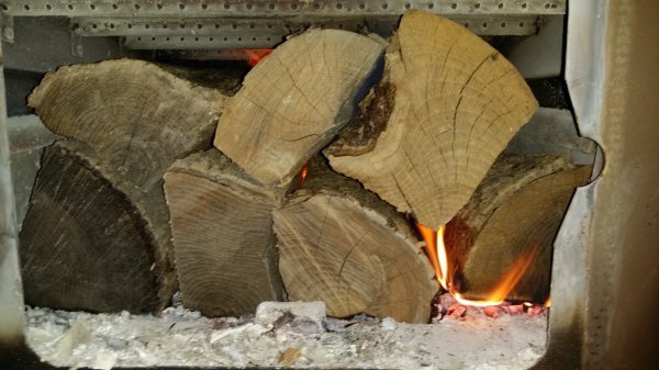

    DexterDay , how long of a burn does that give you? With what wood species, and how operated? I'll be running mine on Washington woods - mostly pines and douglas fir, plus tamarack.

    A mix of ash, oak, and hickory.
    If I load it full at 10pm, I can reload at 4p-5pm the next day when I return home on a good bed of coals. I then burn a hotter/faster load (2 if they are small) and reload at 10 pm again. It probably only produces good usable heat for 10-11 hrs. But I always have a good bed to relight on.

    As for air operation, the max is the primary spring equal to the ash lip. Most times its like Dave stated. About a 1/4" open is my average
