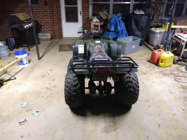

    Put a new seat cover on it. Had it around here a week or two. Finially got to it. I think the old gorilla tape and the memory of that old vinal is all that held it on. Pretty much every staple was rusted and gone!
    I went back with stainless staples. Hopefully these won't rust out. I'm sure the cover will tear before these go bad.
    And yes I know I have a tire on backwards!:rofl: :lol:I dropped it off to get mounted with a tube. The guy said you forgot to tell me the side. I said yes I thought about that after I dropped it off. He said I guessed. I said well it's the other side, he said I can turn it around and I said nah I don't feel like waiting for that, won't make any difference anyway. Haha I have one for if i need to back out of somewhere, it will dig better that way:rofl: :lol: IMG_20210606_212910255.jpg

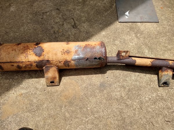

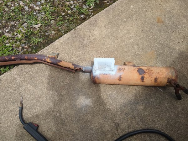

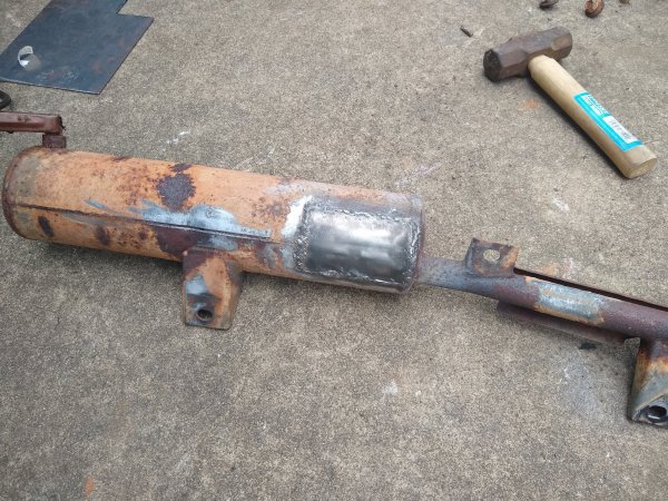

    Pulled the exhause off and welded a patch on the muffler. I tried to weld it on the machine but it was too thin where the seam was blown out and I kept burning holes in it. I found another small hole in the middle of the seam middle of the muffler. I welded a small like 1x2" patch over it as well. Just didn't take a picture of it. IMG_20210613_123938400_HDR.jpg IMG_20210613_124653017.jpg IMG_20210613_133152092.jpg
