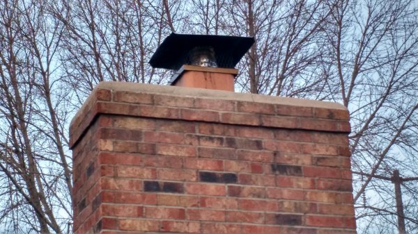

    This is how it sits now. Yes that's creosote. The old chimney as huge as it is would cool the smoke/ fumes down and cause creosote, regardless of how dry the wood was. The top plate is flat, silicone caulked down to the Terra cotta liner. The old 14x14 square cap is bolted down with the retaining screws. The SS liner his the top of the square cap. It needs to be that high for the round cap that came with the stove. I assume all other caps are like the round one I've got.
    I'm thinking of cutting the wire mesh off with el grinder just above where the angle hits. That way it will be secured with 4 bolts until it totally cures, there's a drip edge which I like, and then u can simply put the round cap on and enjoy a fire tonight.
    Otherwise I'll have to wait until tomorrow night, then hope the silicone is cured. It's dark when I get home, so I don't like that idea, plus it'll be dark all week when I get home. So that wood be no fires until next weekend. No thanks to that.

    That's it. I'm going on the roof now. I'll cut off the screen fit the old cap. Then fit the round cap, and light a fire!!!!
    HDRock, Eric VW and Elderthewelder like this.
  17. Horkn
    29,214
    166,714

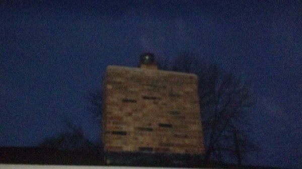

    Done. I cut off the mesh for the old cap, used the lower part of the old cap as a locator/ clamp until the silicone dries.
    Fire's going.
    Here's my results, it's just been lit, so that's why there's a bit more smoke than it should have.

    Happy for you Horkn. Looks good sitting in there and appears to be a nice big heater. And you got it in before any serious winter weather rolled in!
