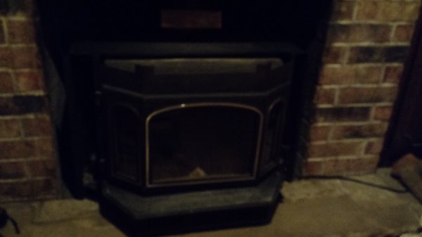

    This is Horkn 's in another hour or two.

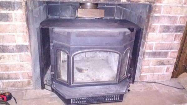

    Here's some progress..
    We didn't get it finished today as we ran out of daylight, but it's in the fireplace, hooked up to the SS liner.
    The heavy lifting is done, and we had to use a angle grinder to cut off over half of the hardware to hold the damper plate at different amount of opening, but, if it were needed, it could either be welded back on, or the damper plate simply placed back up in the damper on an open position. It's all good either way. I hope it never needs to be used again.
    I've got to level it, put the roxul down by the damper plate, put the face plate on it, then get on the roof again, and seal the top plate on the chimney with some more insulation at the top of the liner under the top plate. I need to also cut off the excess SS liner, and put the cap on.
    Tomorrow looks good for weather as well, so this should be no problem.

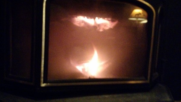

    All leveled and ready for the face plate
    Here's the surround on after I got the roxul in the damper. IMG_20151205_194707851.jpg
    Then I got impatient.
    The fan even on high is quieter than the fan on the wood rack of my fireplace.

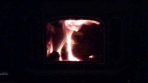

    Yeah, I don't have the top plate or cap on.
    That'll go on tomorrow.
    It's nice and warm.
    wildwest, HDRock and Eric VW like this.
  15. Horkn
    29,278
    167,204
    That's only with 4 splits of sugar maple in it.
    Like I said, I didn't want to go overboard on my first fire. Plus it's not that cold out tonight.
