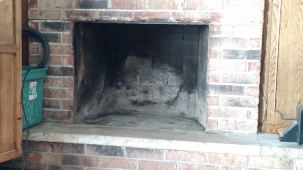

    Today's the big day.
    I took the doors/ faceplate off, and took out the heatilator rack, and cleaned the fireplace.
    My buddy's coming over at noon.
    Getting the ramp for the dolly prepped too.
    FatBoy85, papadave, Loon and 7 others like this.

    OK, buddy's running late, buy I got the chimney swept, the ramp to the patio door in place, all tools ready to go, damper plate out, and now I'm just taking a break waiting for him I'll check the clearance for the liner through the damper, but I think I'll be fine without having to hack the damper. Maybe I'll have to grind off the damper plate tabs top and bottom, but that still wouldn't ruin the old damper, plus that wouldn't be that hard.
    It's upper 40's out and I'm sweating in a t shirt, jeans and my old green flannel.
