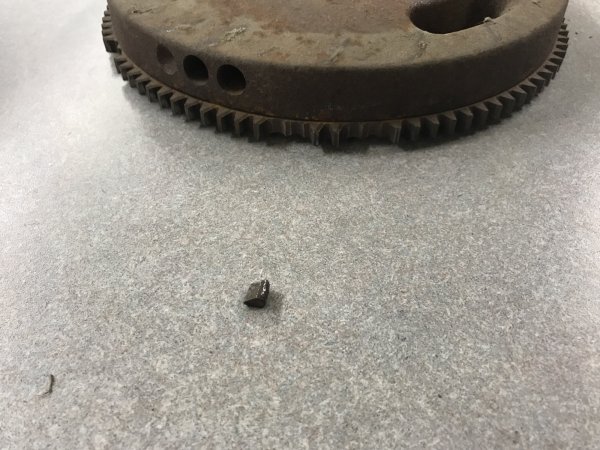

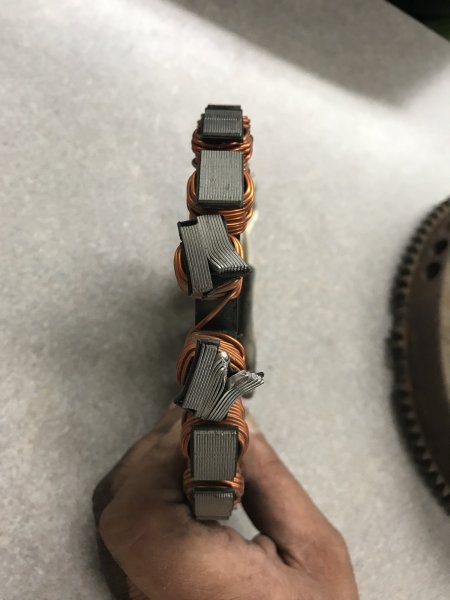

  11. papadave
    A few days ago, they narrowed the problem down to the Stator. That requires removing the flywheel......which for some unknown reason started losing teeth a while ago.
    Lo and behold, one of those teefs dislodged and tore up the stator. Sooooo, new flywheel, new stator, and it should be up and running by this time next week.
    Going with this. It'll cost about 1/3 the cost of a brandy new sorta mid-range LAWN tractor.

    Any suspicions on the flywheel (rotor?) teeth?
    The mower doesn't run on meth, right?
    :eek::whistle:
  14. papadave
    Not a clue. Factory defect?
    In the Pines, farmer steve and Chaz like this.

    So, here's the culprit, and the victim.
    More teeth missing on the other 1/2 of the flywheel.
    Tractor is home, resting comfortably on the trailer until I get out there to unload. Bank acct. is lighter, but my mind is at ease.
    Now, I can get back to work.

    If the flyweel was a factory defect, I'd google it and see if others had that problem.
    See if new flywheels are better or the same.
    Might be a good time to sell it now before it happens again...
