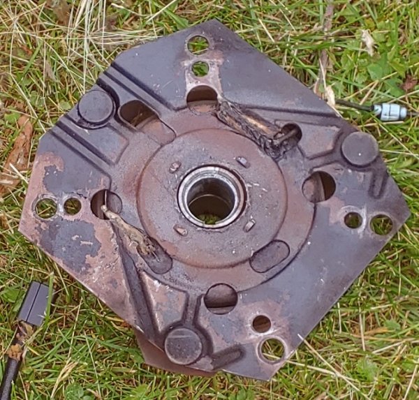

    Barcroftb, Eric VW, Chaz and 3 others like this.
  9. amateur cutter
    5,996
    48,758
    Hey, that was a pto clutch before it became a paperweight.:doh:

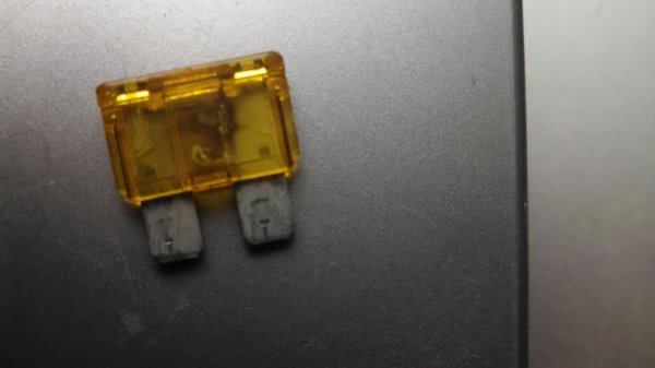

    Well, looky what I just found. Yep, blown fuse. No idea why that would happen, but if that's the problem, it's an extremely simple fix (and I don't have to find the multimeter).
    I'll buy several, just in case.....you know, I decide to mow the ditch again.:picard::rofl: :lol:

  16. papadave
    So, trying to pop in a new fuse and it blew right away (nice little light show). Pulled the neg. cable and put in the fuse, but the cable sparked like crazy when putting back on and of course the 2nd fuse blew (I bought 2 5 packs).
    Something else is wrong. No bad connections at the switch, and I can't see any loose/frayed wiring.
