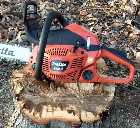

    Already done!
    I had to make a few cookies since a few of those ash rounds were too long,
    Cuts nice and straight again. It was doing the curve cuts with the old worn out bar.
    If you're looking for a new bar, granted the dolmars use husky mounts ( unless you use an adapter to use Stihl mounts) , the online store I got this from was the best price.

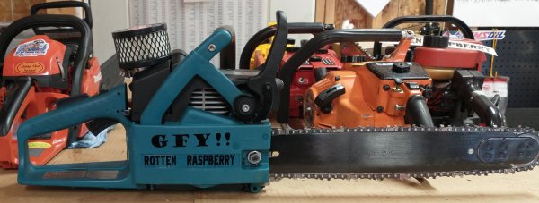

    I really like them both. I converted the Smurf to .325 and run a vintage Remington roller nose bar on it off an SL-9 saw. Originally I was running 3/8 lp on this bar but the tip was wider than the kerf so it would get hung up in the cut so I did the .325 x .050 conversion which fixed that problem. I put the velocity stack and filter on before Kevin ported it. IMG_20201121_163310234~3.jpg IMG_20211213_151932691~3.jpg
