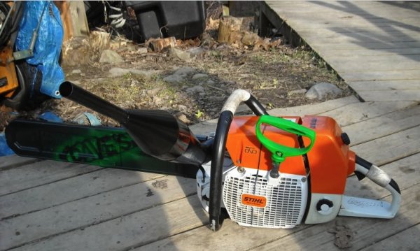

    Tuned exhaust high performance 2 cycle engines use some of the exhaust
    to up the performance. Notice snow machines exhaust are horn shaped, this is tuned for max performance.
    Notice the exhaust on the little radio controlled airplane engines (2 cycle, tuned exhaust engines)
    Venturi effect to pull out more exhaust then, if tuned properly, it uses some of the exhaust pressure to push some of the fuel & hot exhaust gas back in the cylinder just
    before the piston goes up past the exhaust port. Improves the compression, air & fuel mixture.
    More RPM. They SCREAM!

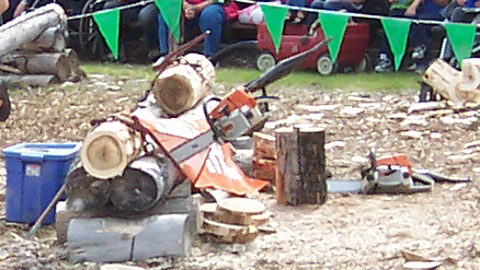

    Tuned exhaust horn on a racing saw:
    I see these at the State Fair Lumberjack show

    I wonder how much those huge exhausts bump the power on those comp saws?

    If the engine is built for it, the tuned exhaust makes a big difference in power.
