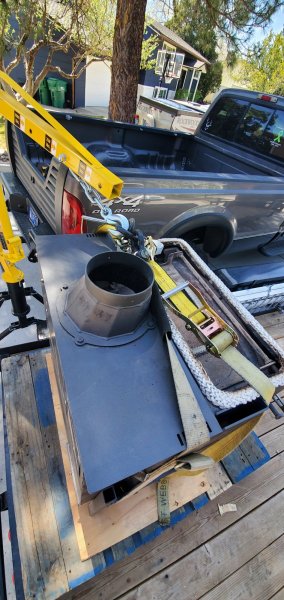

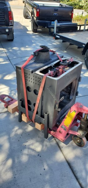

    These are the tools I used to get it off the pallet and then moved it into the house and in to its final resting place...
    A 1000 pound (set at 700lbs) hitch lift and a 20.5" pallet jack with 4x4s under the stove. Worked great and was pretty easy to do and maneuver. 20210423_113158.jpg 20210423_110723.jpg 20210423_113144.jpg
