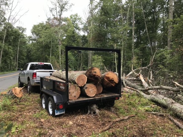

    You had to ask LOL. Who am I kidding, glad to reply.
    My original plan was to have the tower in the back 8” taller. Once I stuck the tubing in I thought it looked too tall. Wish I had stuck with my original intent and be dammed with aesthetics. Extra height is always good.
    I also intended to cut and reweld the tower to allow it to angle back just a little. The day I was welding it all together was the day I heard the trees were coming down. I decided to skip the angle,,,,,at least for now. Could always add it later.
    FWIW can’t really tell from the pic but I’ve buttressed/ strengthened those rear pillar posts on the trailer. They’re not intended or built to take that kind of punishment. Didn’t want to see the back of the trailer fold up like a beer can.
    All in all it’s working pretty well. Broke my middle finger right at the top knuckle drilling the half inch holes for axle u bolts. Three days later I’m loading wood. Gotta call that good :) Might get a blister on my thumb from pushing the button.
    Still using the short ramp I had made from before the tower. Hard to say if I really need it but it does also aim the log into whatever pocket I want.
    Need to build sides for the trailer. I also have an idea in mind for Spiked shoe that will pull the logs aboard more easily.
    Right now I’m using a choke chain to pull nose of the logs up. Detach and reattach in rear to slide forward. The quick release swivel block come in handy for that. This shoe, if it works would speed up the process just a bit by not needing to get the chain out from under the log. The winch does the work but it still takes a little time.
    PS. I bought the ten foot trailer for added maneuverability. Wish I went with the ever popular 12 footer now. 2 extra feet of wood on there is always good.

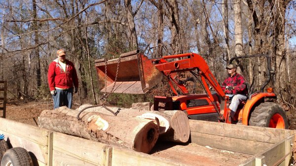

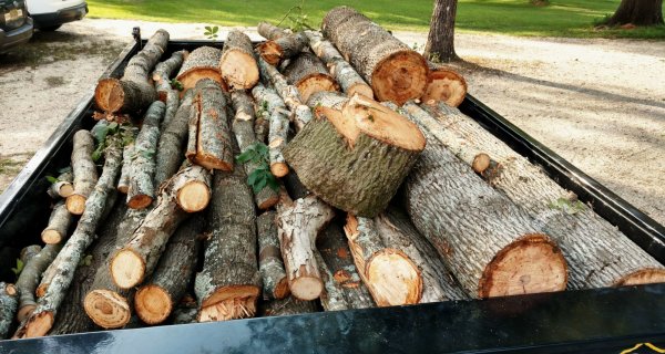

    Good ideas you have there. Just a thought, be careful if you put sides on there, you will overload in a hurry. This is a load of hickory and white oak, not even piled higher than the sides. Weighed 7200 net, about 700 # over stated limit. No problems with it though. Might also try log tongs to pull your logs.

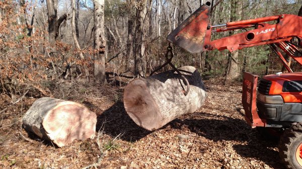

    Tongs are all I use mostly. Just need to make sure they have sharp points. I use tongs and a short chain on the hooks on my FEL or hook them to back of tractor if I'm pulling logs. I was just thinking about ease of moving them on the logs as you pull it up on the trailer.

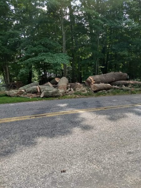

    Good to hear Backwoods. I’ve heard on this site it’s a favorable wood. I should probably let that tree rest awhile and work on the red oak first. Tree warden came around again today, twice. He’s happy as all get out that people are taking the wood. Helps his budget. Competition is showing up. That’s quite OK by me. They mostly want the small dead stuff. That and there’s plenty to go around. Plenty more coming. Warden clued me in on more closer to my house and pretty soon they’re going to be cutting on my road.
    It’s a wood hoarders heaven around here right now LOL

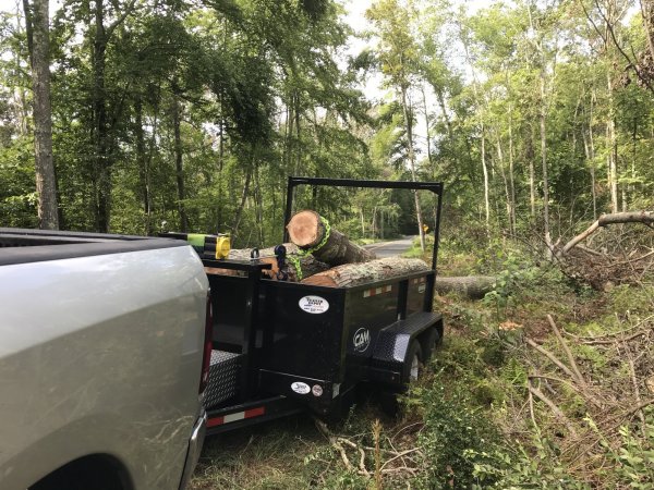

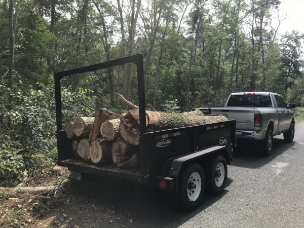

    Two more loads today.
