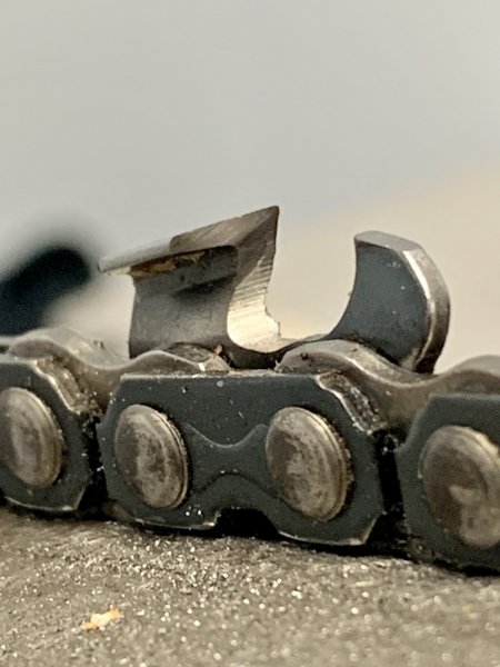

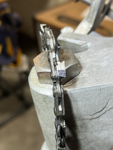

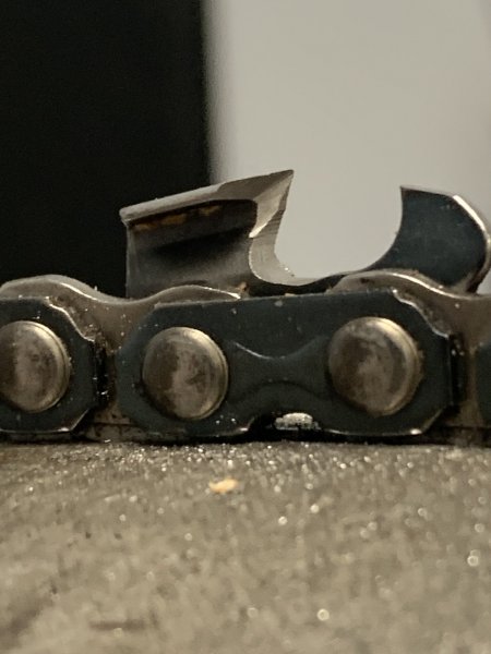

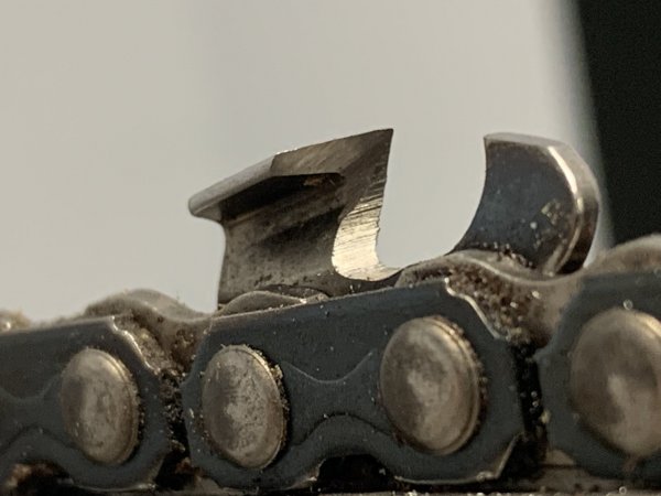

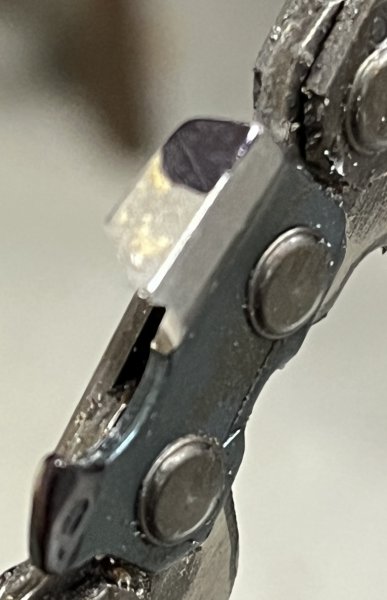

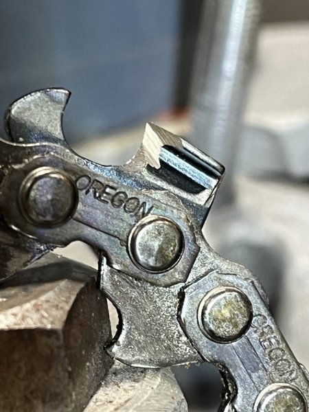

    Lots of progress! I always rake up the noodles because my wife uses them for mulch and chicken coop bedding. Sucks that you hit metal. It looks like it can be cleaned up without losing too much life in the chain?

    Yes it can. Yesterday I had my breaker/spinner out ready to possibly replace those hit cutters but it didn’t take much to get them back. What I’ll do is mark those cutters, then I won’t file the depth gauge/raker down quite as far, so they aren’t “worked” as hard, in a effort to catch the rest of the chain up to the amount that was removed. Since it was random cutters, not all in a row, pretty sure it’ll still cut perfectly straight.

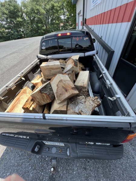

    Took the 20 minute ride on lunch break to get the rest of this wood.
    Also got a large contractor trash bag of noodles, tightly packed.

    Jason I"m curious as to how you mark those damaged cutters ??

    Black sharpie. I always mark a L&R cutter when grinding/sharpening, so for the damaged one’s I only covered 1/2 the tooth. On that 36” loop, I used the Husky depth plate for rakers. Those damaged teeth got the hardwood side, rest softwood.

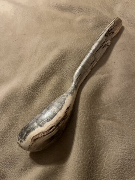

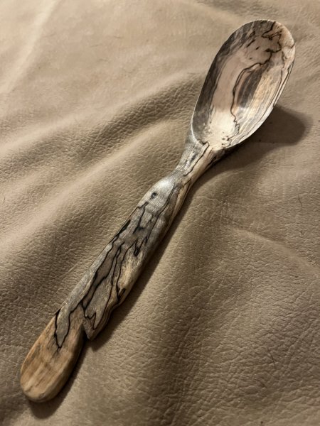

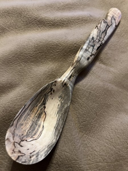

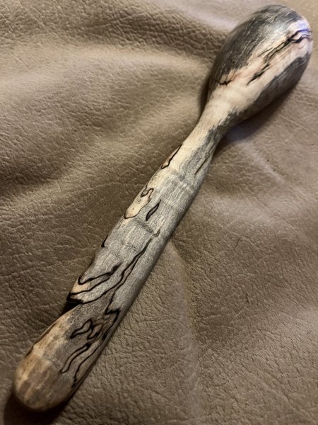

    Soooo.. while splitting this horse chestnut, dad threw several pieces to the side. He’s a carver and belongs to a club. He took a bunch in to their weekly meet and let people try it, they all raved. He gave me a spoon he made.
    78DB860B-0DA4-45C4-85F4-2FEE35C85E85.jpeg 04195A7A-6FE1-4886-ABAB-9EAD067299D8.jpeg 7B24B176-95CA-49D2-AB45-13E3CB42CB78.jpeg 93F5896E-DD30-4F66-83D7-91F2DAAB4999.jpeg
    One of the guys also turns. Wish the one on the left had finish but it doesn’t.
    I saved several crotch pieces and some burl. Hope to see what they do with it.
