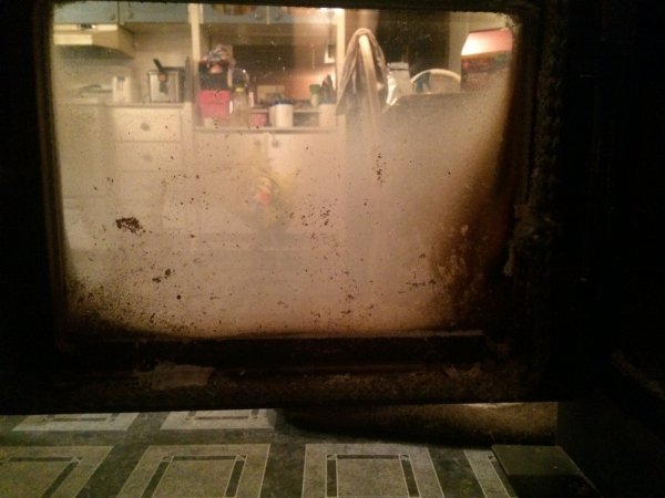

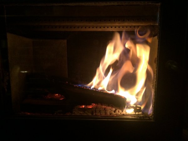

    image.jpg image.jpg Finally cooled the stove off after a 3 week 24/7 burn. Mind you, I didn't clean the glass when I swept the chimney Nov. 3rd, so who knows how many weeks of haze here.:eek: All better now lol
