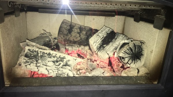

    A0F9989A-AA8C-42D8-9192-6ABAB245C359.jpeg Whew. Now I know the mix I need to produce this clear glass.

    I use a piece of heavy paper towel...dip it in water....dip it in a bit of ash...rub the glass with the wet ash....take a clean paper towel with clean water, and wipe off the smeared ash. Comes out looking like brand new every time. :)

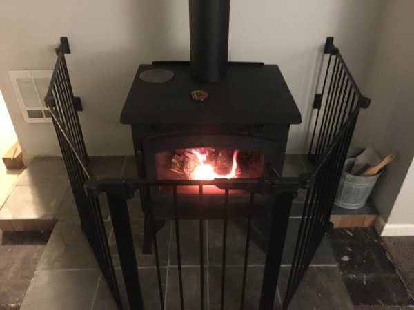

    Very nice! Anonymous tip, watch out for lil ones "helping" you or the Mrs clean the glass and clogging the air wash vents ... :whistle:

    I do the same thing but this fire was hot enough, took care of it for me.

    I have a fence going around the stove, I just opened the gate and took a pic. Daughter had already gone to bed too. 6B02A09C-8989-4CA2-B3F4-72184A8FCF0C.jpeg

    Missed a couple spots in the bottom corners. :whistle::rofl: :lol::rofl: :lol:
    It's pretty cool how that happens isn't it, FatBoy85 ?

    It is, Ive only had fires like this maybe2-3 times since having it. One of the bigger things to realize is how much dry wood does impose on this. Last week, I had a fire that turned the glass corners about 30 percent a golden brown. But I had been burning short low temps fires with soft woods then.
