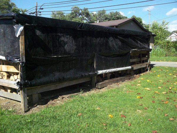

    I built a "convertible" shed a hundred bucks at a time, total cost was 6 to 8 hundred clams over 3 years.. 100_0719.JPG 100_0720.JPG the bunker tarps roll up and down, I have installed a metal roof since these pics,,

    Love it. Let me know when you are coming over to build one like it on my property.

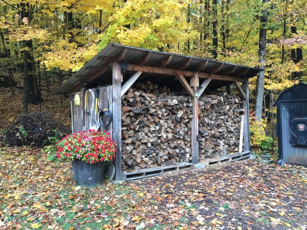

    My 'primary' wood shed is the one in my avatar picture to the left. It is 8' deep by 16' wide and holds about 6 cords when stacked full to the rafters. The bottom is lined with hardwood pallets. I just finished filling it last weekend and it is ready for the winter. I try not to touch it until we get some decent snowfall or at least freezing weather, as 6 cords does not hold me all winter and I usually run out in late March. Until early December, I burn junk wood - old pallets, chunks and uglies, knotty stuff that doesn't fit in the stacks well, pine, punky stuff etc. If it will burn it goes in. Someday when I get a gasifier boiler, I will have to stop that practice, and I know that it should all be seasoned and dry anyway.

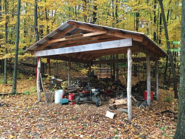

    My other shed (need to take and post photos) is 16' x 16' and consists of six black locust posts, each about 6" diameter, set 5' in the ground and 10' tall. I built a roof structure on the poles with rough-sawn lumber and metal roofing. It has no sides, so it's basically a big wood-and-metal cover for the wood stacks. I built it last year but the only thing it's stored so far is my tractor and a pallet full of apple logs. It should hold 12 cords stacked 6' tall. I am just beginning to fill it now for 2017-2018. I have found that a year's worth of covered drying in my smaller shed, even with species like white oak and locust, is enough to get the wood nice and dry to burn. I don't use a moisture meter, I use a 'clink test' - if the wood goes 'clink' and not 'clunk' it's dry. Weight, visual appearance (end checks, etc.) all are good indicators of drying as well. As long as I keep the wood split into relatively small pieces, off the ground on pallets, under a roof, they will be dry enough to burn within a year. Oak may be an exception but I don't have a lot of it nor do I have a lot of experience drying it.

    Here's my 'primary' shed, 95% full for the season:
    And here's the 'secondary' shed, which will be full later this year with 2017-2018 wood and maybe even a little 2018-2019 wood.

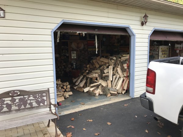

    It just keeps going.....

    I have straight been collecting wood from any and everywhere...Craigslist, stopping when I see stuff ...I been going for days
