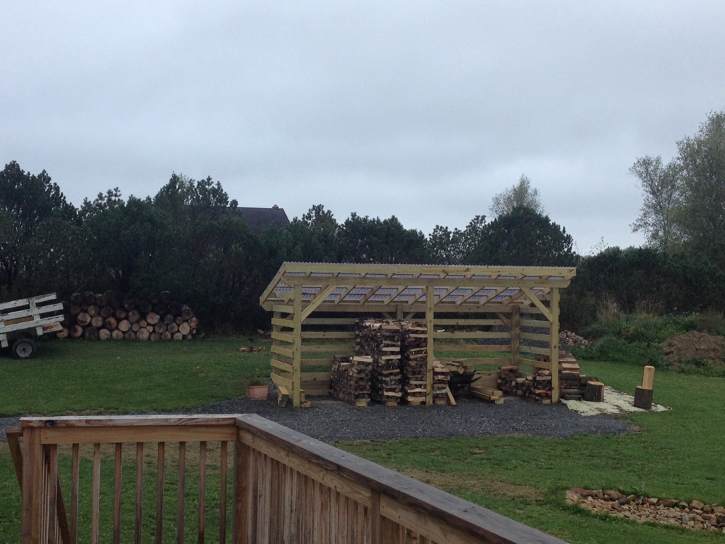

    This one cost me about $1200, but I went with all treated wood. I was on the fence about building one but figured it would serve me for the next 40 years, hopefully. I put the wood on 2 x 4 runners and stack front to back to help with first in first out and allowing rows of oak to sit longer. It is cut into the slope otherwise would leave back open to allow access to wood from both sides. Only other change would to make overhangs 1.5' instead of 1'. It is fairly windy all the time and with clear roof I hope it seasons well while in the shed. Time will tell.

    Trike rider do you have a roof on that thing ?

    Yeah, clear poly roof from building center. That and 6x posts were half the cost of shed. It is 8' x 20', so with 6' stacks and 5 per side I should get 240 square feet per side or 7.5 face cord, which is more than a typical years worth for me.

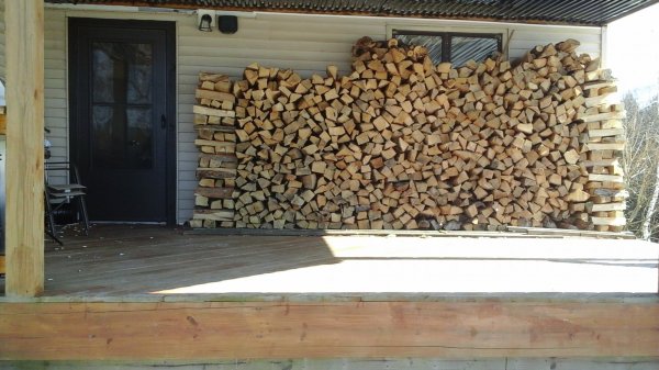

    I agree with Shawn the attached woodshed is the best, but I built mine to hold 10 to 12 cord 20150322_152026.jpg
    Just don't tell my wife as she thinks it her wine and sunset deck in the summer... :whistle: We are filling it now with wood for winter..
    like everything it has it good and bad points... at this point who likes to restack that much wood... but I got a :tractor: so when I get forks I can just load a few pallets on deck and Good to go.. IF pallets are still good in 3 years...
    So my recommendation is if you have a spot build a deck or porch.. I also live in real snow area.. not uncommon to have 2 feet on ground 4 months a year.. but lately its been ice so... real nice to get wood 2 steps from the door... yes I work very hard to be lazy

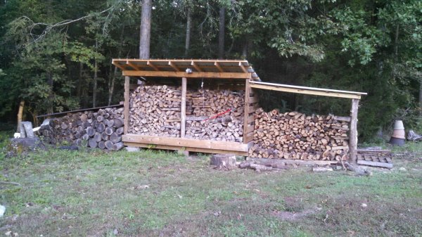

    I built most of this last year so I had a place to stack the bulk of our firewood. I just added the overhang on the right a couple weekends ago for overflow. We built a barn earlier this year and the trees they cleared out are in a big pile on the property. I feel I need to chip away at it before it starts to rot even though we have probably this years and nexts already seasoned. We don't go through cords and cords of wood like most of you; North Carolina isn't known for it's deep, cold winters! But most of it was leftover barn materials including the roof and the posts for the overhang are cedar trees. Oh yeah, the slats are fence boards we had for our horse pasture fencing project (ongoing). We had ordered extras for when they get broken or need to be replaced so the wife wasn't too pleased I stole from our backup! I say repurposed...

    wow nice, except you need to get splitting all them logs on the left.lol

    yep, then I'll need another shed!
