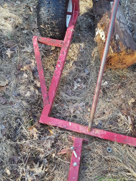

    Looks like I'm finding the week spots on the Country Manufacturing Log arch. The tongue is bolted on to the main frame to make it easier to ship, but the bolts apparently aren't strong enough...:eek:
    Looks like I'll have to take it to the welder and get it fixed up....TurboDiesel style!:dex:
    I have a welder/coworker that we nicknamed...Donk ...he'll have a way to make it last.
  13. HDRock
    17,268
    60,522
    Oh well, a welder will do the trick :yes:
  14. Eric VW
    24,584
    141,861
    Or grade 8 bolts?
  15. Shawn Curry
    Shawn Curry
    Jul 31, 2014
    3,755
    22,702
    Western NY
    Same thing happened to mine probably a dozen times now. That’s what I was talking about at Walt’s place. If they get even a little bit loose, they’ll shear as soon as there is any stress on them.
    I happened to have an entire box of those type of bolts cause they’re the same ones I ship with my sawbucks. But I gotta get it over to my dads and have him weld it.
    Eric VW, Chaz, TurboDiesel and 4 others like this.
  16. bocefus78
    bocefus78
    Oct 14, 2013
    3,694
    19,840
    Indiana
    Locktite, lock washers, and locknuts in the meantime?
    Eric VW, TurboDiesel, Chaz and 5 others like this.
  17. brenndatomu
    25,377
    165,403
    Yeah they'll shear a lot easier when loose.
    Bingo, grade 8s and some green Loctite along with a nylock nut...she ain't going nowhere without tearing something else up too...unless there are just flat out undersized.
  18. TurboDiesel
    16,245
    97,592
    They are (cheap) 1/2 x 3.5 bolts, but the connection is a really poor design! The tongue is always pulling directly on the bolts. Not the box tube frame of the arch.
    There should have been a "C" channel on the tongue for the frame of the arch to sit in. The channel should cradle the frame and all the bolts would do is keep the frame from falling out.
    (Doesn't matter how much loctite, lock washers, and lock nuts you use if the your pulling directly on the bolts. You can't really tighten the bolts because you'll just crush/flatten the box tube.)
    It think maybe I'll get rid of the bolted connection altogether and probably weld the tongue on solid then add/weld a triangle of flat steel over the whole area
  19. HDRock
    17,268
    60,522
    Best fix :yes:
  20. billb3
    10,513
    54,568
    A bolted in triangle plate of 1/4" aluminum would probably be enough.
