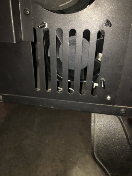

    The heat build up around exhaust blowers does vary greatly from one brand of pellet stove to another. After talking to a pellet stove motor expert, one thing is very clear. The heat from the stove destroys the bearings even in the best of motors! Therefore keeping the heat around the blower down in any stove may greatly increase the life of the blower motor.
    So I got an axial 3.6” x 3.6” AC cooling fan and wires it up to the exhaust blower using spade lugs just clip it in, Then mounted the blower onto the back panel. In this way, the cooling fan goes on and off with the exhaust blower. The fan is a good quality double ball bearing with an aluminum case.
    So how does it look? Comments?
    I took some initial measurements and with the stove set on heat level 3 with the fan on, I get about 145 Degrees F on the magnetic plates. With the cooling fan off the heat goes up between 10 - 15 Degrees.

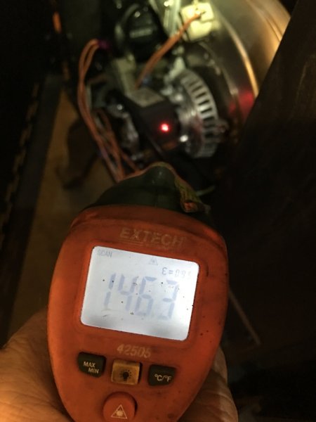

    Hello

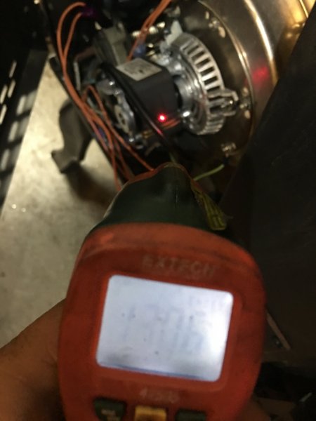

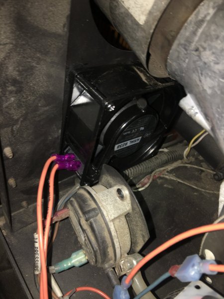

    In the same spot, Stove is On Heat level 2
    Pic 1 - 130 Deg F with cooling fan
    Pic 2 - 146 Deg F without cooling Fan
    Eric VW, kappel15 and heat seeker like this.

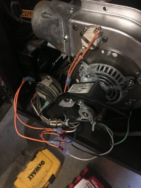

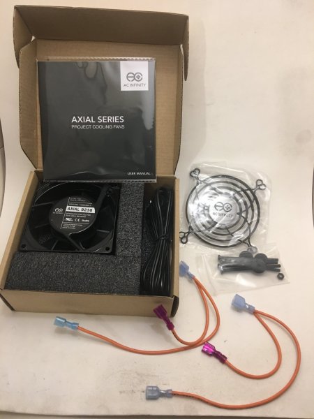

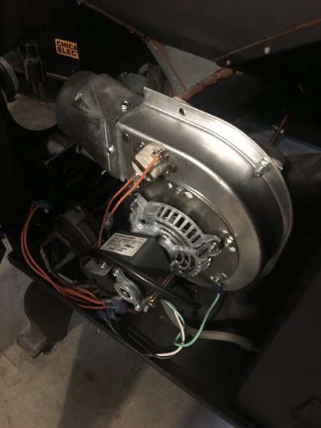

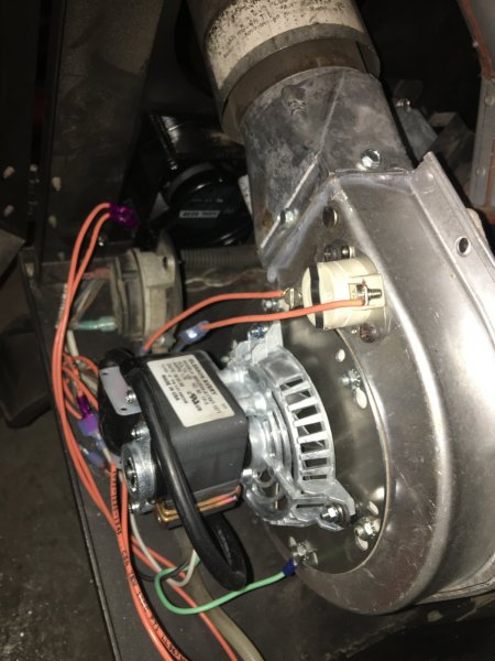

    New kit
    See pics and orange hookup wires
