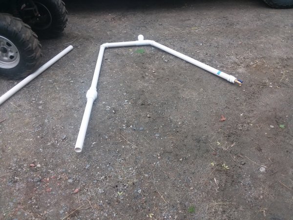

  5. Well Seasoned
    83,790
    This is roughly it. Dry fit, need to take some measurements.

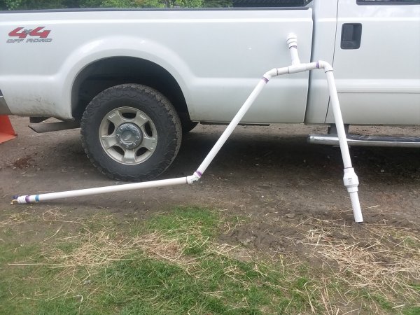

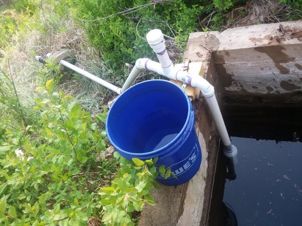

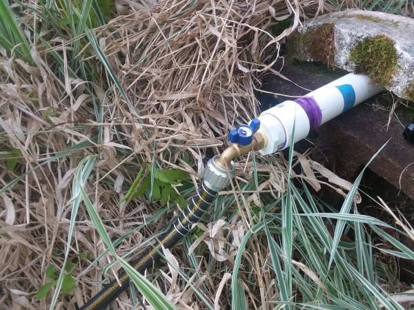

  7. Well Seasoned
    83,790
    That's exactly what I think keeps happening basod! I only have room to go down maybe another foot- shallow well. Will this help? The above picture is a rough design, below is the unit all glued up. I keep getting about a gallon, then lose it. Connections look good, the water level vs the elevation drop maybe? I'm done screwing with it tonight. Was hoping for a bit more pressure and for it not to lose siphon on me.

  8. brenndatomu
    25,311
    164,785
    That's not a spring check is it? Siphon won't open a spring check unless you have a lot more fall than you have there
  9. justdraftn
    justdraftn
    Aug 7, 2017
    1,032
    7,482
    On the road
    I would guess that the spigot is too small to hold the siphon.
    It can't pass enough water to maintain the pressure.
    Just a SWAG though.
    What happens if you take the spigot out and just let the
    2" pipe pull the water....to test.
    I thought you needed the check valve right on the end of the pickup.
    basod, Pallet Pete and Well Seasoned like this.
  10. brenndatomu
    25,311
    164,785
    As long as its below the water line during priming it will be fine.
    The PVC check valve that is in stock at our local Lowes, and looks like the one you used there, is a spring check...I think that's the issue, the flapper type sump pump check valve that they used in that video earlier is pretty much ideal for this application.

  13. brenndatomu
    25,311
    164,785
    Shop ProPlumber Plastic Check Valve at Lowes.com
    This one is a flapper type...should work.
    How much further up is the other well/spring? 1-200' of garden hose may be worth it if there is a big difference in elevation...if you really want good pressure...
  14. brenndatomu
    25,311
    164,785
    Also, the cap that you take off to prime needs to be air tight once re-installed...any air leak will cause loss of prime. A coat of pipe dope on the threads (if its threaded) should be enough to seal it up without having to crank it too crazy tight...
