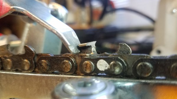

    Back at the 3/8. I set the depth stop to stop just below the top plate. Is that low enough? You can see there is dirt and fuzz where below where I stopped.

    Looks right. How many ° are you from vertical? Got a pic from the other side?

    I'm at 60/30/0 does that answer your question? I'm still kind of lost on the whole last number of the above.

    Looks good. Did you cut with it yet? How does it Do? 60° should give you a chain that lasts awhile longer without resharpening

    The last number is the tilt of the vice. Leave it alone, you will be fine. My Silvey has tilt automatically factored in. With the Oregon/Tecomec, forgetaboutit.

    Just as important as the amount of hook, (the 60 degree #) is the steepness of the top plate angle. The smaller the number the longer it will hold an edge. Oregon LGX is 25 degrees but once you get to the witness mark, you can decrease that angle as there just isn't a lot of "meat" left on the tooth. The shallower angle will not dull as fast.
