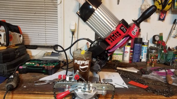

    Loving the input from everyone so far. Life got in the way of grinding progress.
    I've also used up my .043 Pico chains to grind on. They were borderline used up and I made scrap of them but learned alot.
    Only ones I have left still cut wood and that's how they will stay till the new year.
    Lesson learned. Don't try to create hook on chain designed to not have hook....at least not as a noob.
  13. Duane(Pa)
    Duane(Pa)
    Mar 5, 2015
    443
    3,112
    Centre Co.
    In this pic are you working on the rakers? I would say try to "learn" on your 3/8 chains. Everything is slightly more demanding on the smaller chains. Less room for error if you will...
