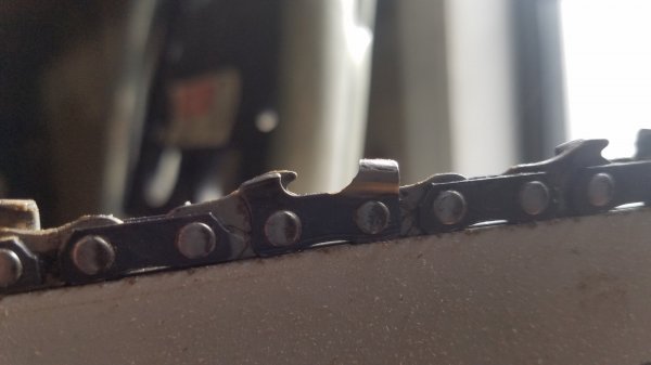

    Yep. That's definitely not the ticket. Cut like chit.

    can you get other side profile of the picco

    Here's the chitty one I tried.
    And here's one that has only been hand filed once.
    Mine sure as hell don't look like the newer one.

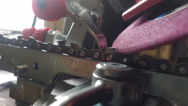

    Here's the newer chain with tilt at 40 and angle at 30. Look like it matches to You?

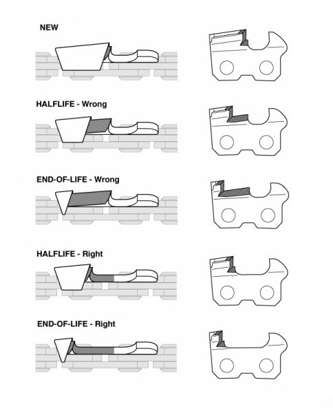

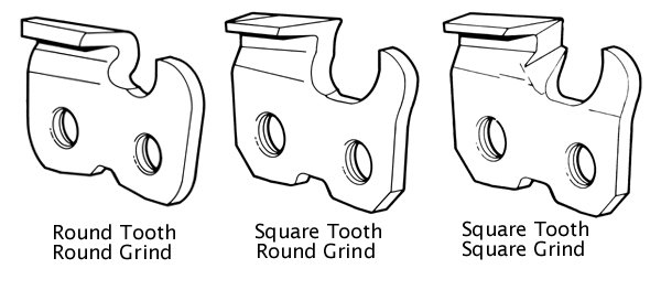

    Take the gullet out with a file and make it look like the new chain below the cutter. I mentioned a few pages back that with round semi chisel like you have there, you may have to go with more angle and get into the tooth a little bit with the side of the wheel in order to get some hook.

    how does your plastic wheel guide look compared to the wheel for dressing

    Check wheel edge profile with plastic gauge. Should be little U shaped slots on one side. Your wheel edge radius looks like it's not quite as round as it should be...

    thats what i was thinking too

    Each respective chain maker has specs that should be followed for grinding. That 40 degree tilt is not one of them. BTW, you are way to deep with the wheel and are sharpening the working corner which is the most important part with the side of the wheel.
